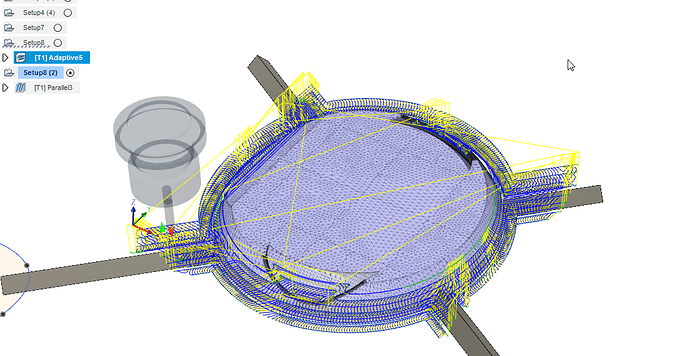

See attached screenshots for ‘set up’ (stock) and tool paths. Any tips appreciated.

Probably not related, but why not generate both toolpaths under one setup?
In F360 CAM, you should only use one setup for each side of the object to be carved. You can have subfolders and multiple set of tool paths within a setup.
Using multiple setups for the same side of a part make you run the risk of different setups, tool offsets etc which can be confusing. Also any previously carved part won’t be taken into account between setups, only what is inside one setup.
I suspect there is some discrepancy between the setups or a no-good tool path sequence.

This is how I would suggest you setup your CAM, one Setup per part you want to make.
Nested within that Setup you place all tool paths required for the part and you can post process them individually / or as a group if you have several paths using the same tool.
The optimum work flow for CAM on this model - assuming you want to use two particular bits for all parts is to first configure one setup and two operations within that, one for flat/roughing and the other for ball/finish.
- Then copy the whole Setup for as many additional parts you need.
- Now edit each copied Setup and Tool path to reflect which model it is supposed to work with and tool path is automatically generated.
I didnt find any obvious suspects as to why it moves to a different place than intended, you could test without the following box checked, Include Setup Model
You dont need to have Rest machining checked either IIRC:
Here is an example of a project of mine, where I have several tool paths within one Setup, flat/ball/drilling etc.
I export gcode for each tool path or one file per specific tool which may have several tool paths nested
