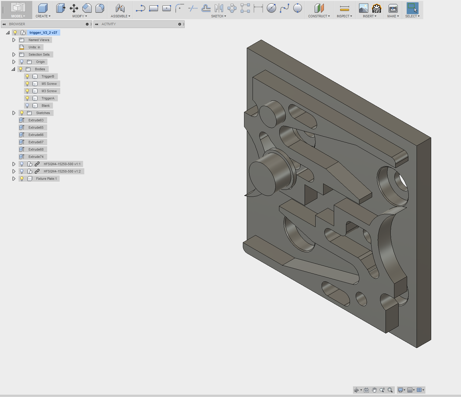

So I’ve been toying with the idea of making a fixture plate for my paintball triggers for about a week or so now. I finally got the CAD drawn up and the fixture plate made. Cut the fixture plate 2 days ago and tonight I finally got to make my first test cut(s).
I did 3 tool changes to make the fixture plate. I started with a 1/8" 2flute AlTiN coated stub nose endmill to cut the larger holes (mounting to the bed) and the profile of the plate. I then grabbed a 1/16" 2flute to predrill the precisely located holes using a pecking drill operation. Then I grabbed my 7/8" diameter - 1/4" shank to face the whole thing down from .19" to .18" in 2 passes, both .005" DOC. Afterward I used a .5" vbit to hand chamfer all holes. Grabbed some 220grit sand paper and my best sanding block, to make the top smooth and get rid of any ripples from the facing operation. Then I ran it over the satin buffing wheel to smooth it all over.
Enough talk:
Heres some of the CAM work I did before I made any cuts. I even got the dimensions of the screws I was gonna use to model it up.
And the fixture plate itself, and the resulting trigger.
^no filing or sanding. There are some spots that look “rough” but I assure you, the whole thing is extremely smooth. Not perfectly smooth, but my post-cut work will be reduced by an order of magnitude.
These are by far and away, the highest quality triggers I’ve produced. Just from the sound it makes cutting, you can tell fixture plate reduces most if not all vibration in the cut. This reduces chatter, big time. They are also the most accurate parts I’ve ever cut. Usually I’m lucky to come within .01" of the CAD specs. The parts that came off the fixture plate were as close as .0005" but as far as .0035" from CAD. This isn’t a $160,000 VMC, so I’m more than happy with the precision, now that I’m using proper fixturing.
The big take-away I’ve gotten from this experiment (that I’m going to scale up for production) is that fixturing/clamping is extremely important for high quality cuts.

@BetaPrints I just did a bunch of googling and watched many machining videos of people using/creating fixtures. NYC CNC and Grimsmo Knives are 2 youtube channels that helped me out a lot. Granted, they have Tormach PCNCs which are in a different class compared to the X-Carve; but the principles of good fixturing should hold true on either machine.
@Travelphotog I considered using a sacrificial waste board. Its a good idea for larger parts, but not so much for very fine, slightly fragile parts like triggers (i think). I haven’t tried it with triggers, because I’m worried the vibrations from the wood could get amplified into the part. Using an aluminum plate makes everything significantly stronger, repeatable, and I have a lot more confidence cutting.
As far as taking the plate off for another cut, its very easy. Its so small I can loosen the tslot screws and just slide it to the back of my machine, theres enough room on the bed. There is some wiggle room if the bolts aren’t tightened down, but when I go full scale it should get better. Also the edge of the fixture lines up with the edge of the Tslot bed which makes it easier to line up quickly. This is just a small scale test, though. The plan, now that this has been a success, is to mill a 3"x12" (or maybe a 6"x12") fixture plate, which should hole about 10 or 12 triggers (or 20-24). I will have that fixture plate on, say, the left side of my bed, then while its cutting those out, I will prepare the next sheet of aluminum to have its mounting holes drilled on the other half of the bed. This keeps the machine running as much as possible. Assuming everything goes as planned, I should only have 3-5minutes of downtime between swapping the plates. The way I’m doing it now means I have to re-clamp after every 4 or so triggers, otherwise the material just isn’t solid enough to prevent vibration. So about 5 minutes of fiddling per 4 triggers.
Also, now that I’ve sort of “figured out” fixtures, I can make them to do 2-sided machining accurately and repeatably.
Cutting a huge sheet of very small parts and using tabs creates a ton of vibration and clamps are just not enough. The main goal is to reduce that vibration to a minimal amount. So I decided the fixture needed to be aluminum. Also I figured if I’m machining aluminum, I may as well machine it how real machinists do, which means making fixtures for production parts.
