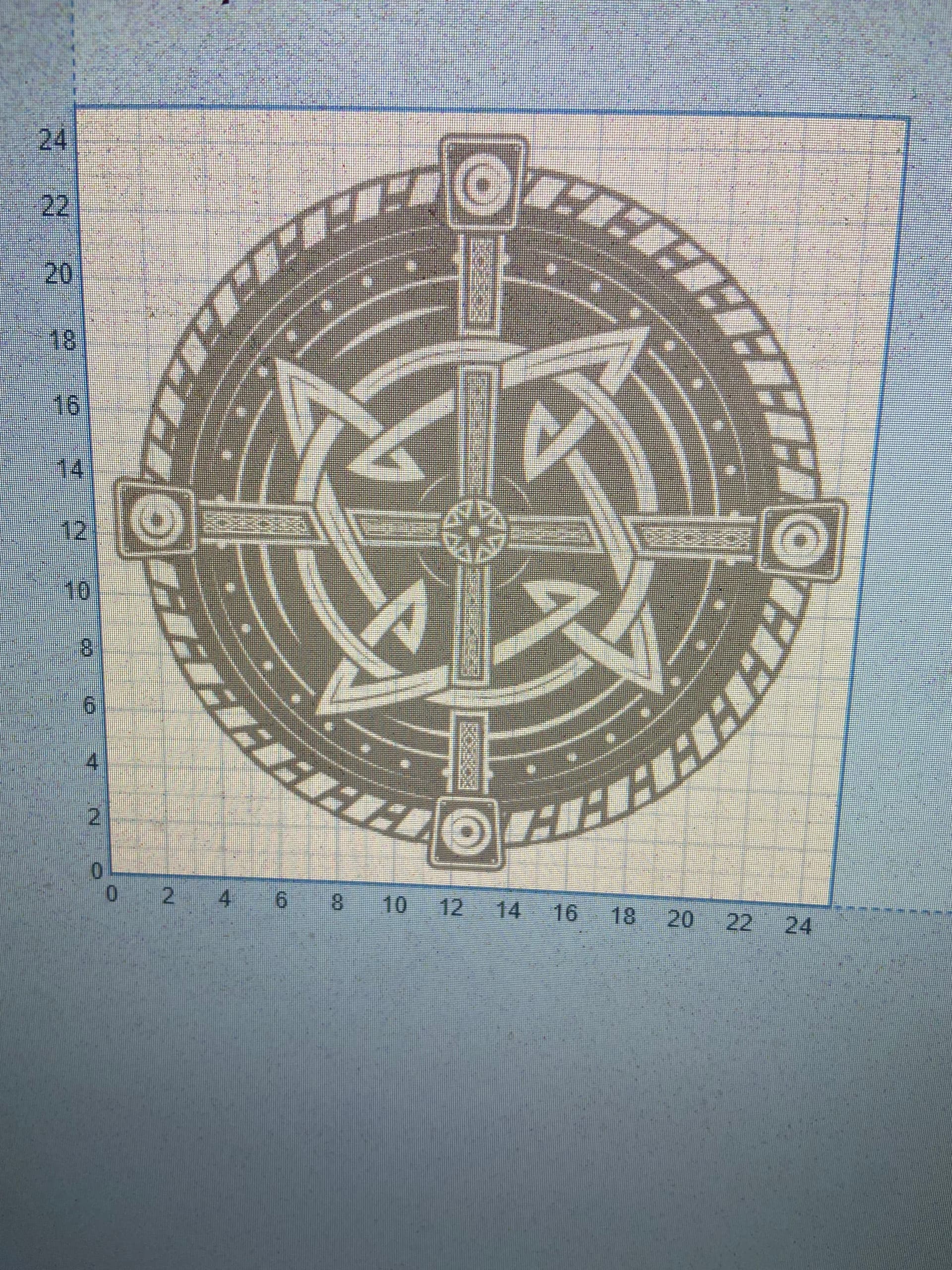

I love this new app. I tried tinkering with it last night for about an hour and got a couple of things I think. Trying to carve a round Viking shield and would like the shield to have a traditional circular curve on the outer edges like the Captain America shield and can’t quite figure it out.

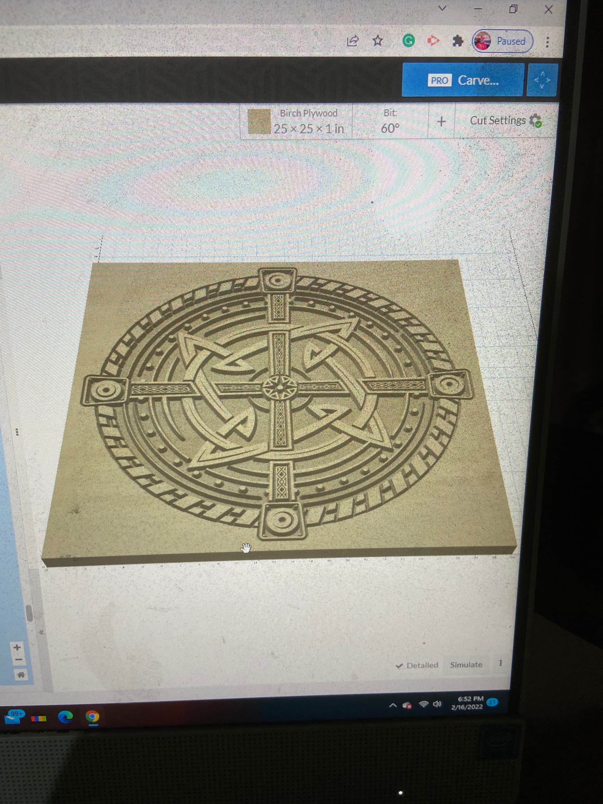

Yes I have a Viking SVG file that I am carving on a 23.75” diameter piece of pine. The look that I am going for is a standard convex shaped shield like your drawing. I have tried playing with the super gradient app but have only been able to create a bowl like image. Also when generating the tool paths it freezes for a very significant amount of time, times out and then I either have to exit out of the entire screen and go back into it or press the “wait” for it to respond and it never does.

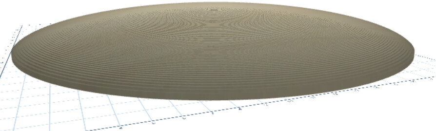

try using this Bezier Cone Generator app instead of super gradient app
You can do it easily with the Super Gradient Generator app. You simply set the “Start Depth” to the stock material thickness and the “End Depth” to zero. Also, set the Curve Type to outer-radius. I used 1000 steps in the file below, but there might be an internal limit; I haven’t checked. The second workpiece is for viewing purposes only…

Update. So I uploaded my svg of the shield, highlighted it and went to apps & searched up Super gradient. It populates my image of the shield and I set the parameters as you stated and when I upload it and “generate” it just shows the image flat. I was thinking I needed to create the same size circle as my image next to it and use the super gradient on the circle with your parameters and then upload it next to my image and then “bring to front” the shield and lay the gradient circle on top but when generating it freezes and does nothing.
Well, if you want something carved into (or out of…however you want to look at it) the face of the shield then you will have some compromising to do. Easel will not conform a pocket to another surface; i.e. your dragon (or whatever you want on the shield) will not be a consistent depth/height with respect to the shield surface. Now, if you are filling a carving with epoxy or something like that then it really shouldn’t matter that much.
