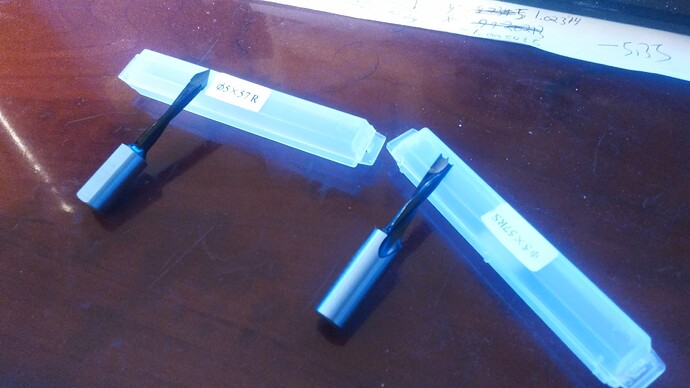

on the contrary though you can use all sorts of drill bits with a cnc machine
but usually you have to have a er series collet system for them to work
you can use things like these
thats how I drilled all of these
you you can use these
http://www.onsrud.com/product/Item/m/itemDetail.html?itemId=70-633
and its best to mount a drill to your spindle so you can go at slower rpm speeds
