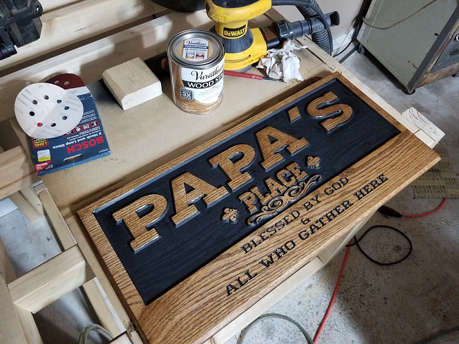

So I get some brand new bits in and decide to use a day of easel pro to try out the 90degree v bits.
The rendering in the application looked great.
I used the stock feeds and speeds in easel since I was new to the vbits and it chewed up my project.
That looks to me like a machine tuning issue. Probably several. Go through your v wheels and belts and make sure your machine is square and trammed
Besides for the fact that you need a tuning, check the file as well for extra “ghosts”.
Also looks like your stepover is more than 1%. When using vBits set your stepover to 1%.
We know the answer is not fun and means extra work but it pays off to do it.
And check your carve depth as well.
I don’t mind extra work at all.
Seems I always have issues using easel.
I think I will stick to fusion.
Funny you mention tuning, x axis belt broke after the job. Belts don’t have but like 5 hours tops on them.
Thanks Phil I will look at it. I’m waiting on some new belts to come in. But gives me time to finish this.

And if it assumes .50" as the bit size for a vBit preset to 60 or 90 degrees, then 0.50 x .01 = .005" step over. :wink:
I will I did a other inspection of the belt last night and there is just not much wear at all on them.

So after some time I finished installing the new belts and tried again. Much better results.
And the machine was for sure not tuned up properly did some more reasearch and now she purrs like a kitten…thats controlled by a computer…and has a router attached to it…hmmmm…nevermind
!!! But results are better !!!
