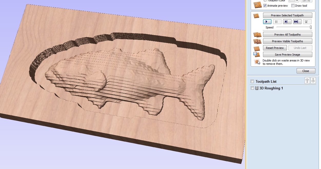

Ok what you are describing is the “Z Level - Raster X” strategy.
It cuts out a “pool” for each level, much like a layerd topography map.
3D Raster - Along X, will move side to side across the whole layer, moving up and down as it goes, clearing everything at once (no “pools”)
(The names are way to similar to no be confusing
I recommend setting up 2 rouging operations, once for each strategy, and running the animations so you can see what I am talking about.
Here are some pictures to help illustrate:
Z Depth Path:
(see all those red move lines)
Z Depth Preview:
3D Raster Path:
(only 2 red moves, - actual 2 for each layer but there are all in the same place)
3D Raster preview:
Personally I prefer the 3D raster strategy. I find that it clears away more material, and lots of red moves seems to add a lot to my cut times. (I could probably tweak my settings to minimize this)

Yeah, it is longer, mainly because there are a LOT more small Z moves, so you are moving more at your plunge rate. But it also clears away significantly more material, Which means less load on your 3D pass so you may be able to cut faster there. Which I where I wound up making up the extra time.
I mostly use Z level for bulk clearing of material with a larger bit on really big prints. I then follow it up with a second rouging operation using a smaller bit. But I enter that bit’s cut depth to match the material thickness, so that it does a rouging operation in a single layer. As it is just cutting what the Z depth pass left behind.
