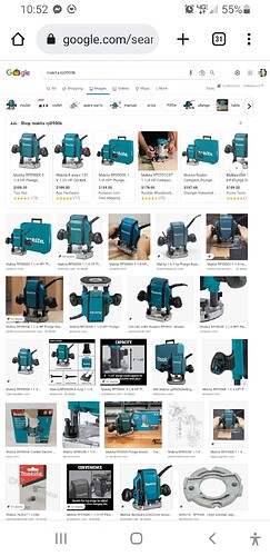

Maybe its in the box, but the Makita router includes this collet, thats why inventables doesnt sell one seperately.
And the most important part pleae note, the part number provied is NOT for the makita 701c trim router. But instead its for the makita plunge router rp0900k which use slightly different cone geometry.
Thanks Seth, that’s a mistake I don’t think I would not have lived down for a while, I’m a bit of a hoarder so went through my boxes and found the 1/4 collet, went straight to Amazon and cancelled my order, saved me $32 :smiley: , looks like I’ll be carving a very cool wolf tomorrow afternoon after work.
