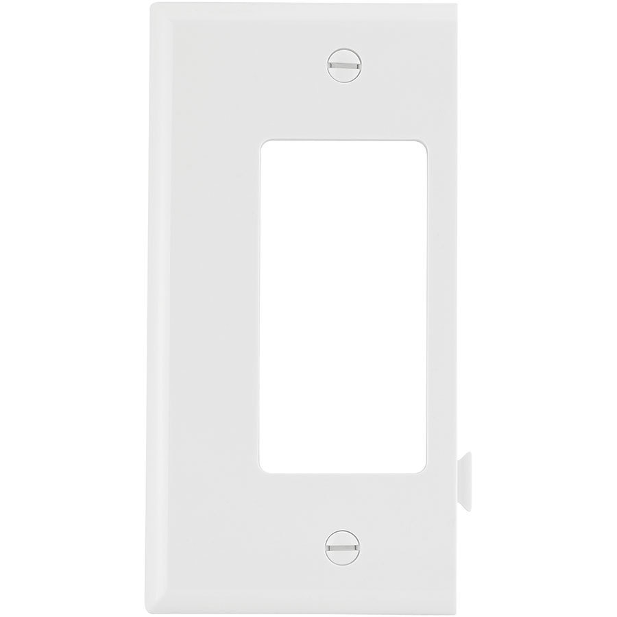

I implemented my relay by mounting the relay and an outlet into an “old work” 2-gang electrical box and then mounting that in my CNC cart. That way I didn’t need to cut the router cord and I could also plug in my shop vac into the other plug and have both controlled by the relay. I used sectional wall plates so that the outlet is on one side and a blank plate on the other side. I can post more pics of my setup if you like.
