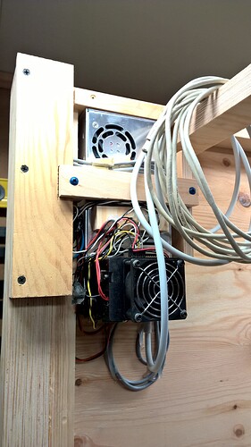

Just want to share how i have done it when it comes to the x carve in a tiny work space,really did not have space for the 1000mm version but that’s the one i wanted and that’s the one i bought :yum:
So here are some pics to show my go at it and maybe there are some ideas for some one in here :
+1:
I had a lot of sag on the belt so i stiffened it up with a little bit of kryssfiner as we call it here in norway,guess that is plywood over there :wink:
Here it is in its upright tuck away position
Wall mount to keep it in the upright position
The last pic is just of me showing how happy i am for my new X-Carve :grinning:

Hi Geoff
Tho i have not made all that much with it yet,been 4 test pieces.
I have not had any issues with alignment.
I have made the table really stiff and sturdy,not much flex in it,i think that is an important thing to have in mind making something like this.
A little bit of over engineering comes in hand i guess :grinning:
Very nice design, HelgeDokken! Could you please give a coupla pics more of how you did the hinges?
Russ from Coral Springs, Fl USA
Hi Russ,glad you liked my design,thank you :grinning:
There really are no hinges,i have used bolts that go trough each end.
Think it is more sturdy that way.
Was just out in the shop and took some pictures,hope this show somewhat how i`v done it :smiley:

Excellent design, excellent craftsmanship! thanks for the close-ups.
It’s got me thinkin’.
