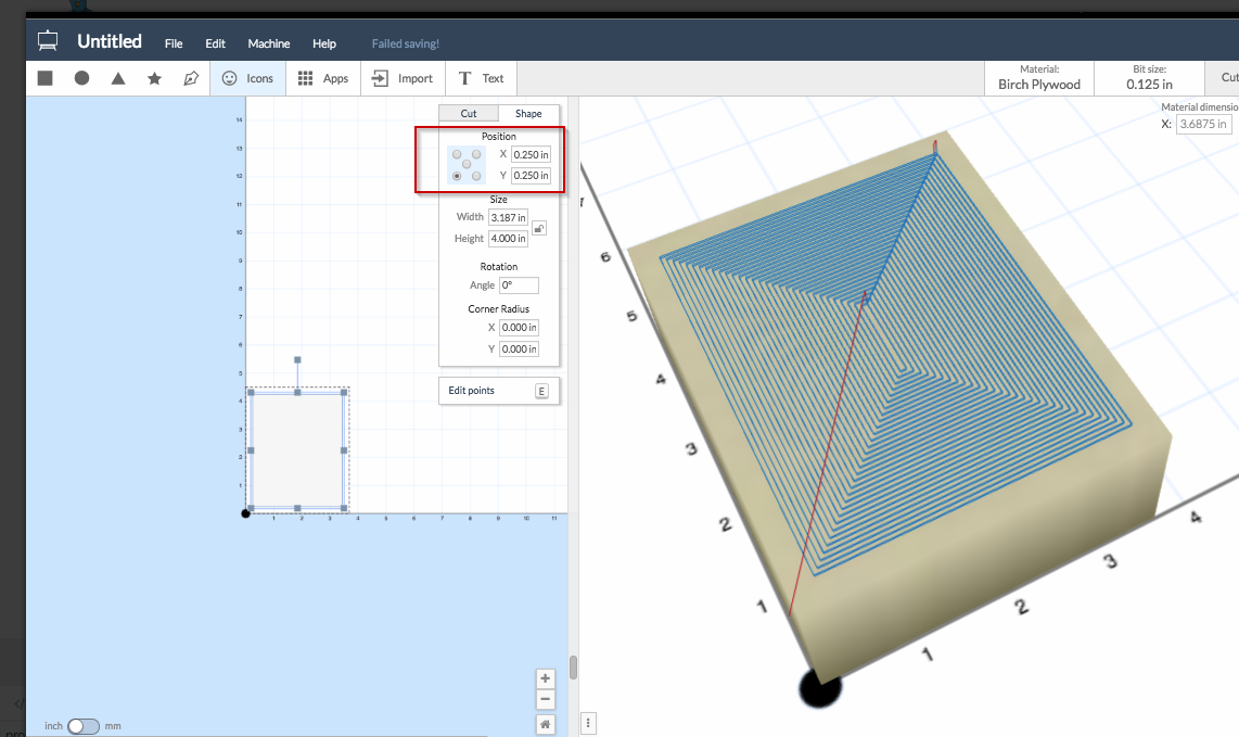

Hi guys, just purchased a 2nd hand x carve and while giving it a few test runs i noticed it was off centered by + 0.25" on both the x and y axis. Any thoughts?
Off centered from where? Is it cutting out of round/square or in the wrong location?
For example I’m trying to carve out a box and instead of being dead center it’s over to the right and down about + .25 inches and in easel the carve of the box is centered
Totally understand that and I have zeroed my bit on the bottom left of my material as well but for whatever reason when it cuts it’s adding more distance than what I want. This is my first CNC anything machine so I’m not to familiar with the initial setup. I did purchase it fully assembled but I wonder if while being hauled for 40+ miles in a truck would have caused something to become misaligned? Is that possible with this machine?

Just so you can get a better idea, this is what’s happening. I zero my work area to the bottom left corner just like easel says to and everything is centered in easel as well. The cuts themselves seem pretty straight but its just in the wrong position.
And it’s always off by the same distance in every test regardless of where I position the material in the work area so I’m guessing it’s some kind of fixed parameter be it software or physical

According to your Easel project, that square is 0,25" offset from Zero.
If you do not want an offset, change your X and Y to 0, not 0.25 in.
Why do you have 0.25 set in the first place?
Because I need this to carve out the dead center of this block of wood. The .25" is the space I want to have from the outside edge to the inside edge, understand?

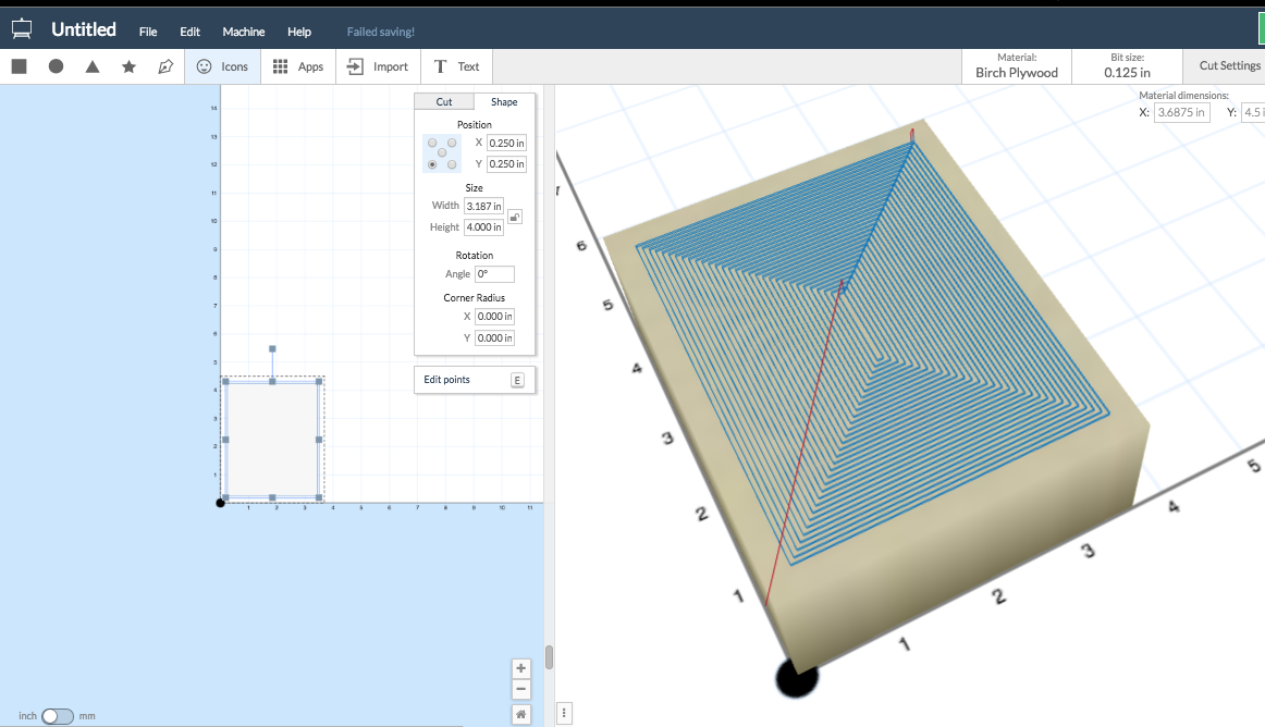

If your stock is pretty square, mark the center of stock, change location in Easel to the center and make position 0,0. Then line cutter up with mark and see what it does.
How about this?
Is the center more critical, or is the border?
Note the CENTER of the shape is 0,0
EDIT: I think is what Stan said; mark the center of your stock, move the end mill to the stock center, and carve.
Yep, that is what i meant… Assuming his stock is the size he wants he should get the correct border width unless there is something screwy throwing it off by .25.

So, just to make sure I understand, I would create my carve in easel using its Zero point as my center and then I would position my end mill as usual to the bottom left of my material. Correct?
