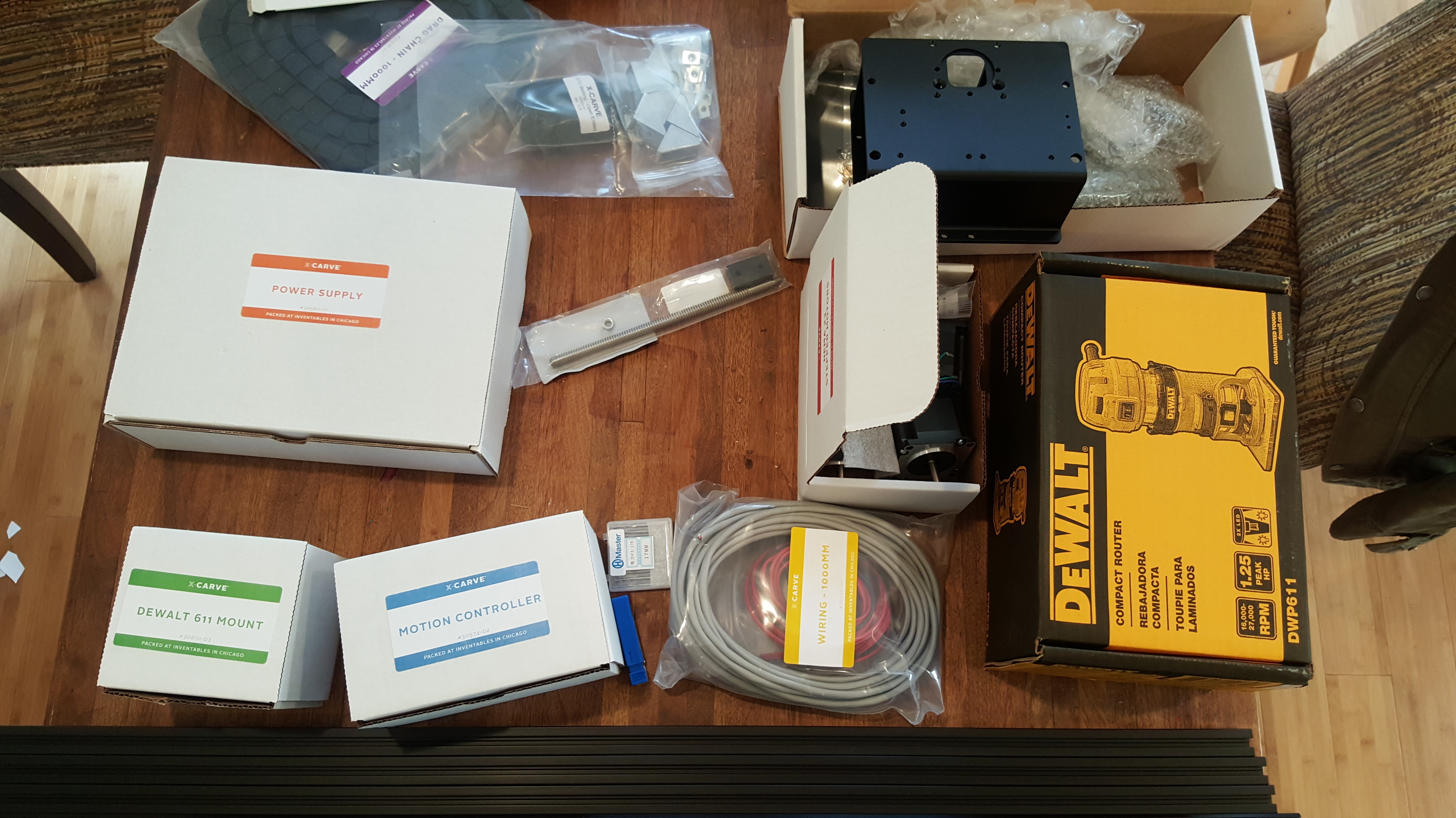

I have been eyeing the x-carve for quite a while now. With a few freelance cheques coming in the budget stars aligned and took advantage of the black Friday deal. UPS delivered early and on a Sunday no less! Thanks to work schedules and family requirements I have only had around an hour to spend on the build. My son christened the machine as “Rob” this week as we were building the gantry carriage. It is exciting to see the family come together to build and dream up ideas for the robot to start cranking out. My honey do list has multiplied 10x.

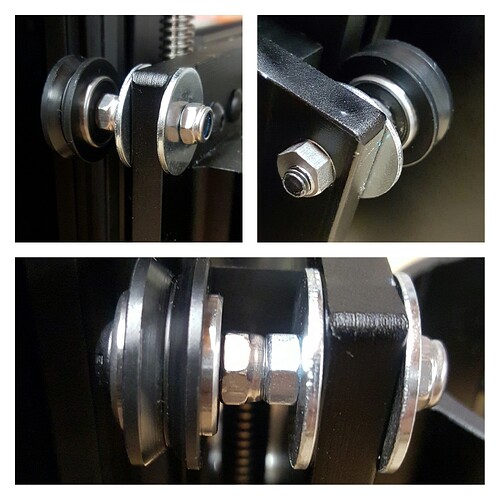

Took z-axis back apart to apply the strength mod by @MattWheeler A mod to make z-azix more stiff and easier to adjust my local hardware stores are slim picking for anything metric and not wanting to wait for ups to ship a few bolts I reused the supplied bolts with 5/32 washers and m5 nuts I had laying around. Took a few more detailed photos to help with clarity
It was a noticeable improvement to stiffen z movements with hardly any flex even without x and y stiffening.
