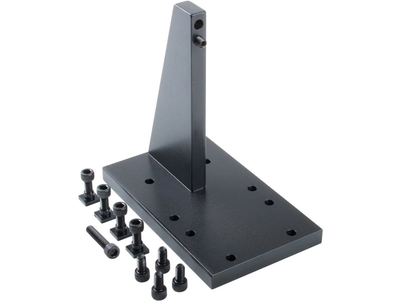

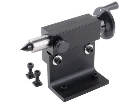

I have these sherline pieces. I carefully bought them used on Ebay to bring down the cost.
The right angle attachment converts the rotary table to an A axis so the workpiece is horizontal. The tailstock has a live center and supports the far end.

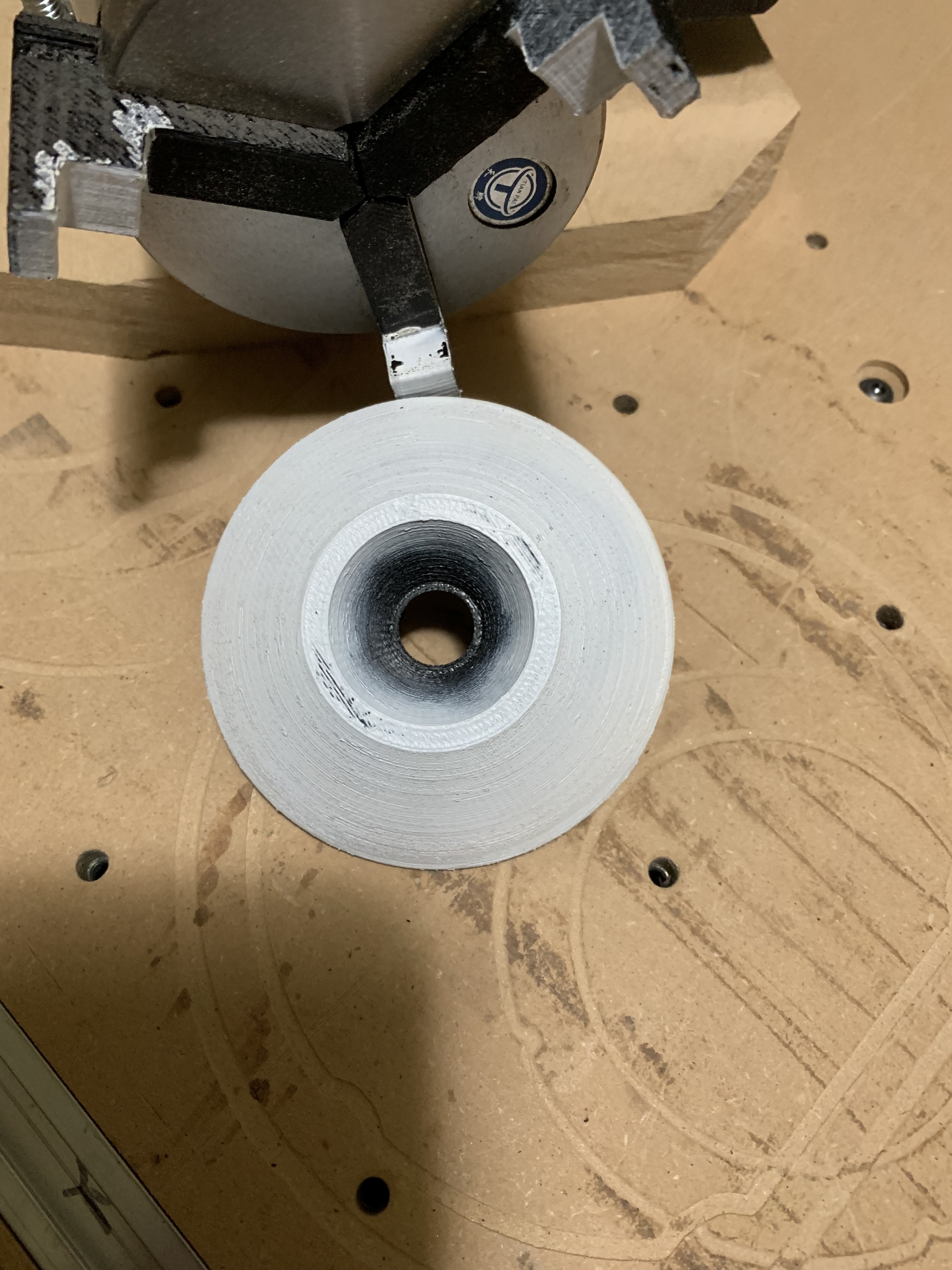

I set up my own rotary / 4th axis.
I am using it to engrave drinking glasses. ( I have included 2 images)
