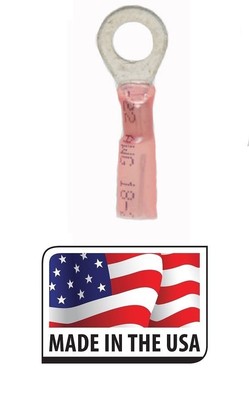

Wouldn’t ring connectors be better than spade connectors. Sure you have to take the screw all the way out of the terminal block to install them, but they can’t pull out. I’ve been switching to the better copper ring connectors with the built in heat shrink and adhesive. This is after a couple of the cheap home depot connectors came loose on me.

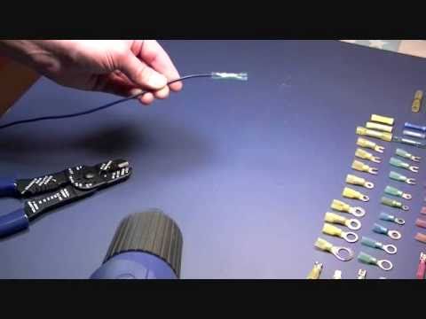

I ordered some of these, they come with the heat shrink tubing and adhesive built in. So you crimp it down with the crimp tool, then go over it with the heat gun, and you should get a solid connection.
and a video on this type of connector
Those look like a nice setup!
