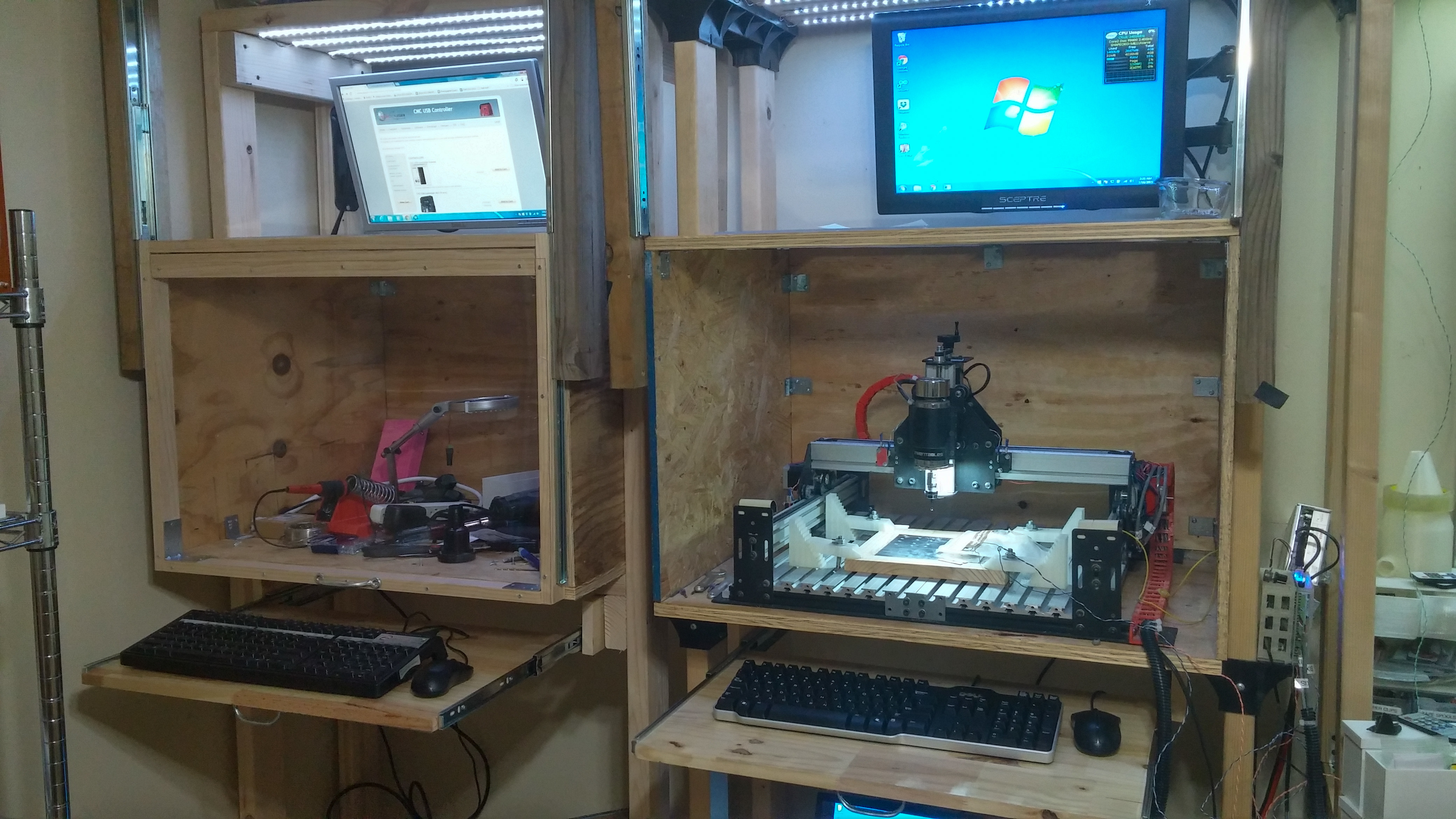

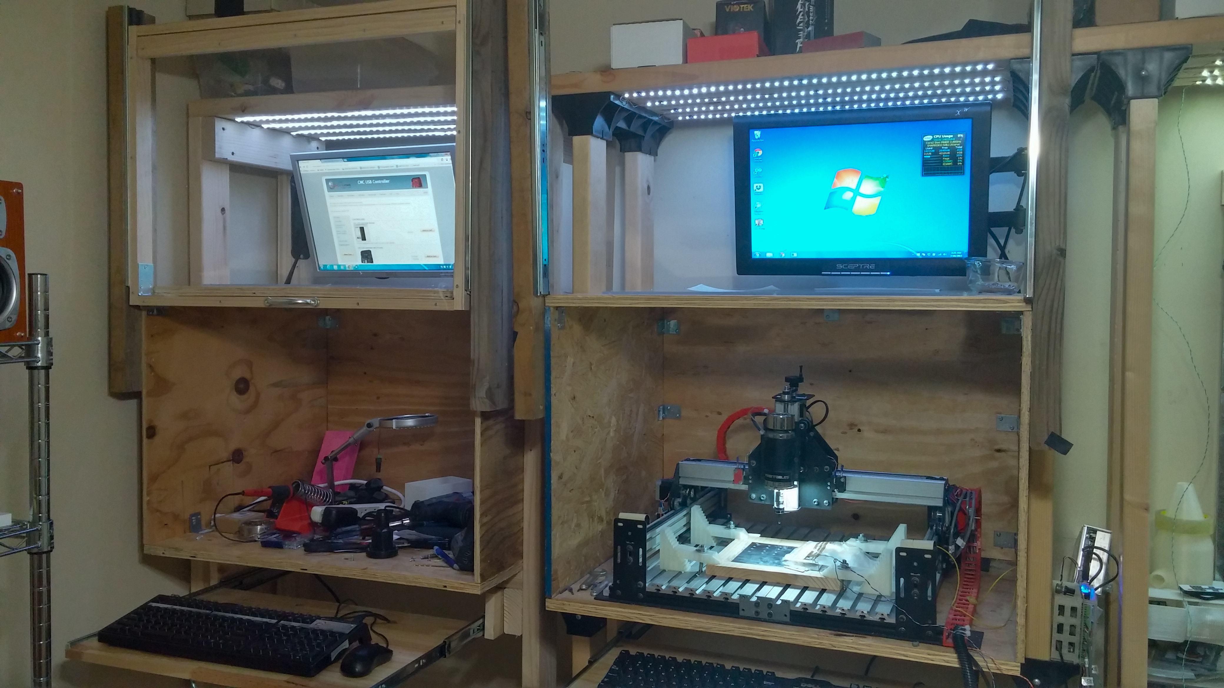

Before I left town last week I was able to install the vertical door on the X Carve side of my setup. This is the door closed.
And this is the door opened. The door stays raised just fine but there is also a safety lock to keep it raised when i have to stick my neck in there from time to time for some odd reason. The top of each enclosure is also topped with a large 1/4" window to both allow in more light (more LEDs will be added inside shortly) and to allow the monitor to be seen by the 5’ 2" wife. Being 6’ 5" the monitor is up pretty high so some consideration had to be made for her.

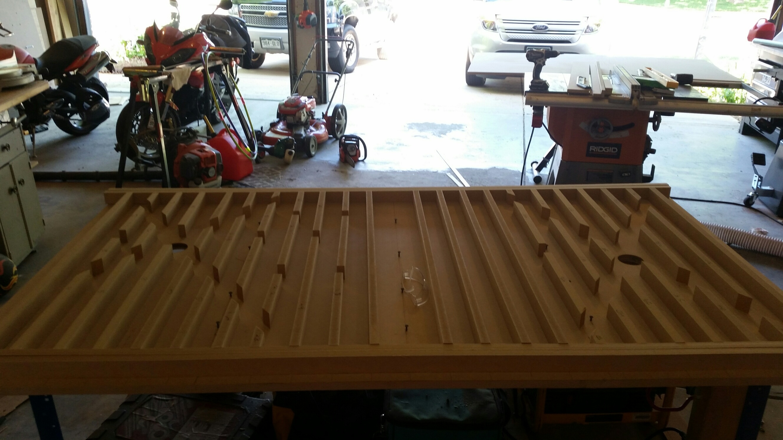

Built my 2-chamber vacuum table this weekend. It’s on top of a Kreg table frame and it’ll run off of a standard 2.5" shop vac (will use the 4" dust extractor to power a hood, at some point).
The left chamber is for the X-Carve and the right will be general use - probably mostly for downdraft sanding. Will drill the holes (at least on the left side) with the X-Carve.
I took more pictures and can send more detail if anyone is interested.
Sorry for the poor lighting in the picture…
Looking good. I’m definitely interested in seeing what people do with vacuum tables. I am going to put one together soon myself. I think a flow-through design would work best for me, but don’t know that I would be able to get the suction necessary with a shop-vac. That being said, what are you (or others) doing for the top of the vacuum table? You mentioned drilling holes. What size holes and what spacing are you planning? I’ve seen others using the grid with gasket design. I’m undecided on how to move forward.

In re the horsepower concern, my idea started with THIS VIDEO
He’s using a very small shop vac. I plan to use a standard (5-gallon, maybe??) shop vac. If that proves insufficient, I’ll cut a bigger port in the bottom and throw the dust collector at it. All materials in my design are 3/4" MDF. The top (not pictured) is already sitting on top of the ribs now. I will probably affix it with screws until I decide that it’s losing too much vacuum, at which point I’ll have to glue it down. As for holes, I plan to start with few, smallish holes until (again) I figure that’s not working. At that point, I may try larger holes or more of them (or both). I have no clue how many, the spacing, etc., but I’m trying to keep with the thinking that it’s easier to drill more new holes than it is to plug existing ones, when looking to adjust vacuum pressure.

On our Multicam CNC we use MDF, and simply skim cut both sides before using it with no holes and a vacuum pulling THROUGH the MDF. Shop vacs won’t be as strong as the industrial vacuum used, but my point is that vacuum can pull right through MDF with no holes.
I guess this is my question. With the flow-through design, the shop-vac obviously won’t be as strong, but will it be strong enough? Have you (or has anyone else here) tried? Seems to be the simplest design.
wow that’s really cool. maybe I will use the dust collector, then!

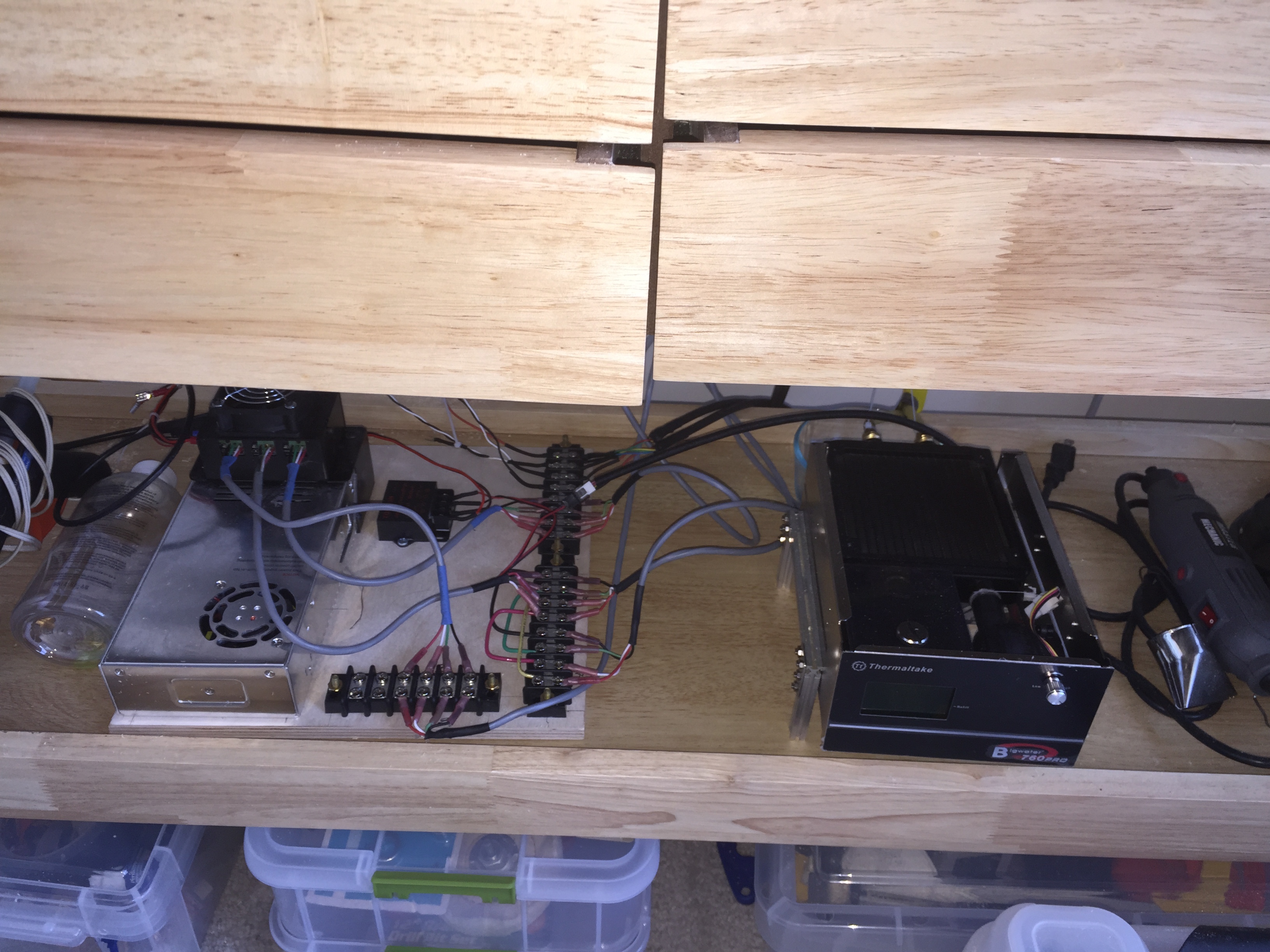

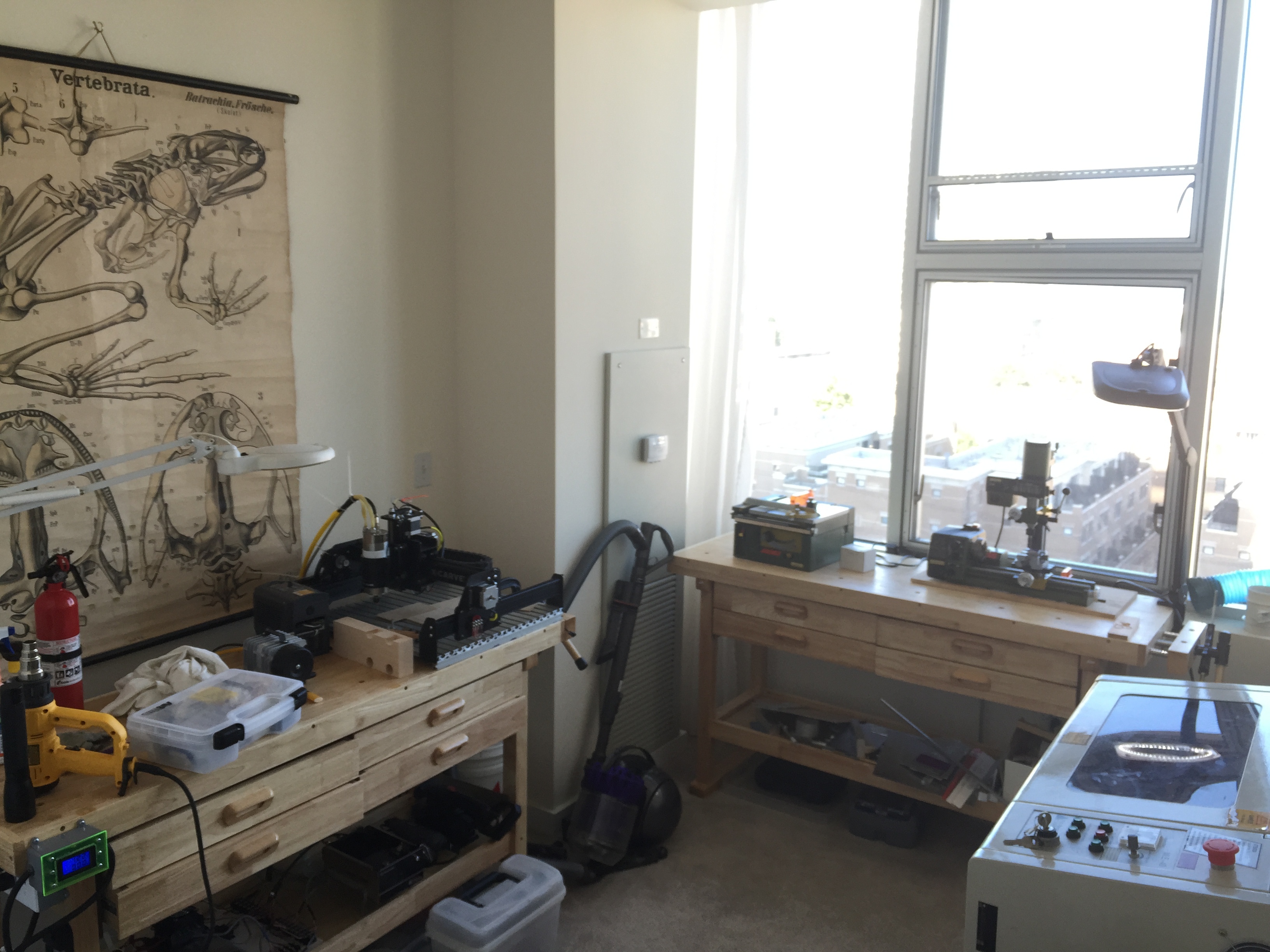

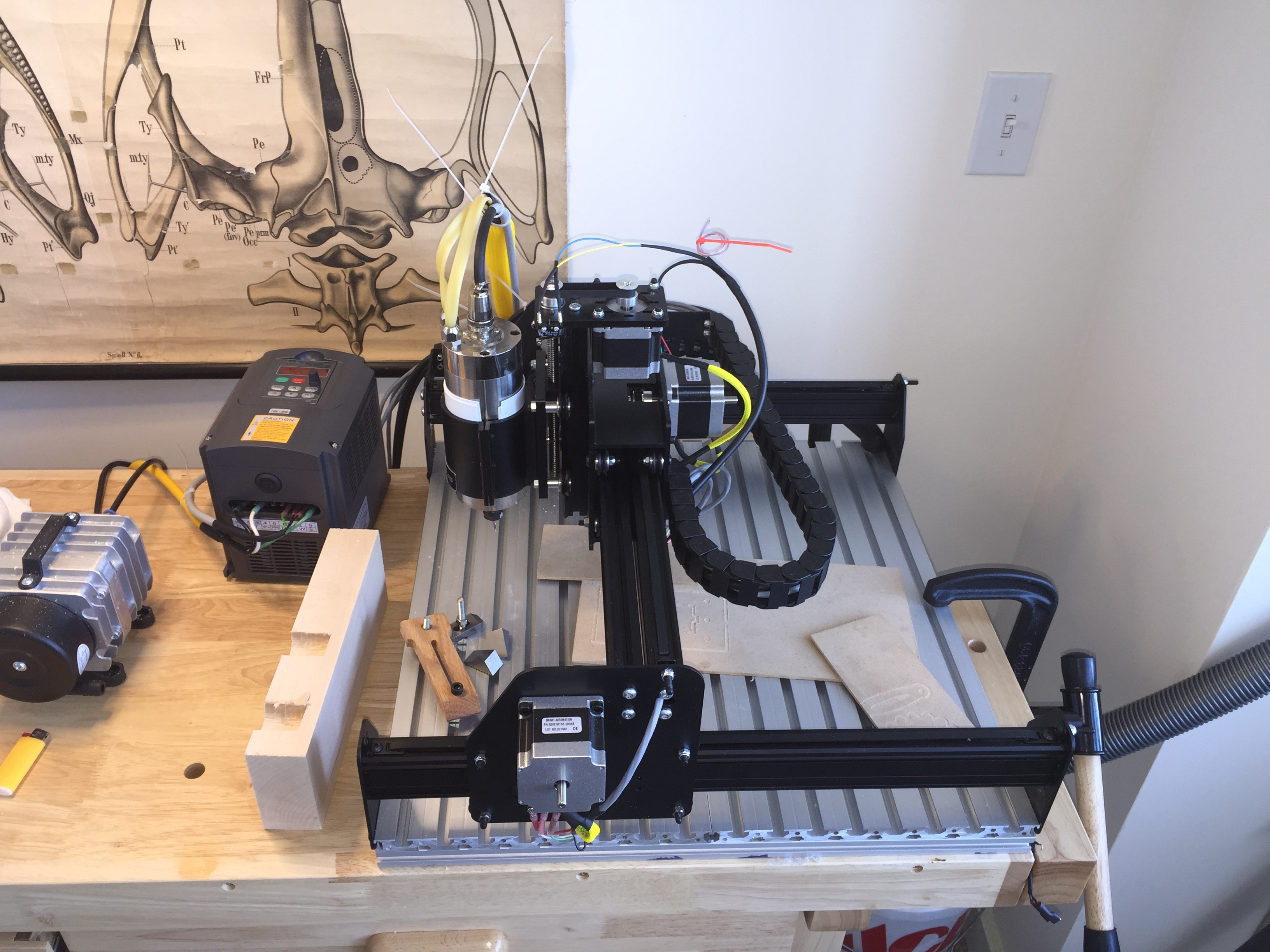

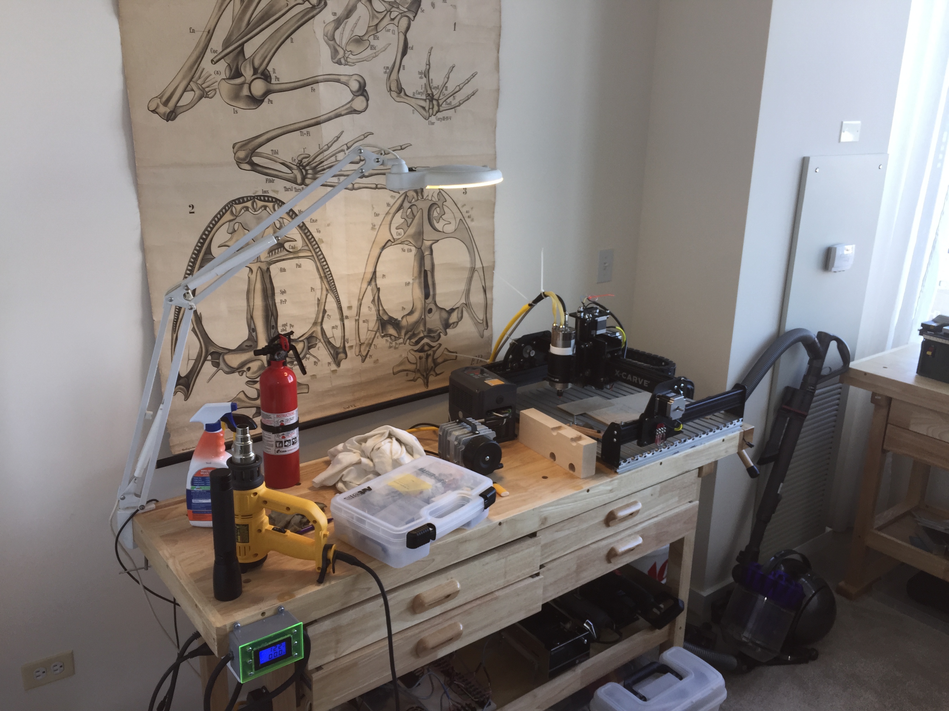

So I thought I would throw my workspace on the thread. I just used a harbor freight workbench. I added some wiring to add a switched outlet (attached to power strip) and current meter. (I didn’t have a nice push-button e-stop switch, but at least there is an easy to reach light switch that shuts down power to the whole system.) The x-carve is clamped down to the workbench. On the bottom shelf I keep the cooling pump/radiator/reservoir unit and the electronics board (which is plywood with all the components, plus terminal blocks, mounted on). I keep the VFD on top so I can easily see the RPM display. Also it keeps the start, stop, and speed controls for the spindle at easy reach.
As my workshop/studio used to be a second bedroom, I still need to replace the ugly white carpeting with something hard and durable. I was planning on putting bamboo down. So far the noise the components produce is very low. The table saw is the loudest, but that is rarely used. It is mostly used to cut stock to size. With the door closed the noise coming out of that room, while the xcarve is running, is no worse than a loud AC unit, and is much less than a vacuum cleaner.

Harbor Freight benches never look this good. Perfect fit.
Got the X Carve installed in the new space and the LEDs added to both sides. About to mill the GX16 pass though panel from 1/8 6061 on the Shapeoko for both mills so the wires can be connected to the X Carve how I want them. Took a bit to design and 3D print the cable chain for the VFD cooling and power cable but it sure does look nice and keep everything out of the way!
Will post a pic of the pass through panel when it is installed later tonight.

Travelphotog, That looks nice! how much does the enclosure cut down on noise levels? I noticed that you didn’t bother to insulate it with any kind of sound dampening material. I’m going to have to make some kind of enclosure like that for mine as well.
it cuts is about 10Db which it pretty good over all. mu sound foam is on the way in the mail right now. I am just going to try and cover the inside top and upper 1/3 of the sides and see how that works. But there is a noticeable reduction in noise when the door is lowered while cutting.
