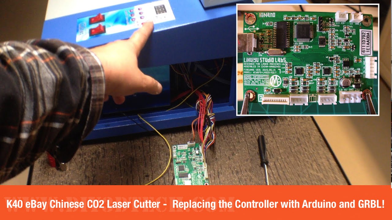

would it work if i buy the little k40 and connect the xcontroller and do this mod?
https://openbuilds.com/builds/uk40ob.3988/
So you’re buying the machine and then only keeping the tube, power supply, and case? Am I the only one who remembers the story “stone soup” from when I was young? At some point you’ve got to stop pretending you’re modifying an existing thing and admit that you’re just building it from scratch.
its cheaper to buy a k40 and use some of its components, than buy each thing from diferent providers
Way cheaper to mod the k40 to make it useable than to build your own. New lens, air assist head, honeycomb table, and boom! Bobs your uncle! I cut some pretty heavy material with mine. It does 400mm/s etching and 20mm/s cutting. You could with enough motivation add all of that to an XC but then you need ventilation.
