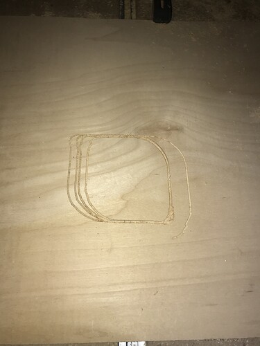

I just set up my Xcarve this week and went to run a dxf file and the router kept cutting off the correct path. I thought maybe it was my dxf file so I downloaded a project from Inventables and ran it, same result. I checked the wheels and tracks. All seems fine with them. See photos.
check carve settings and hardware. eccentric nuts and belts
