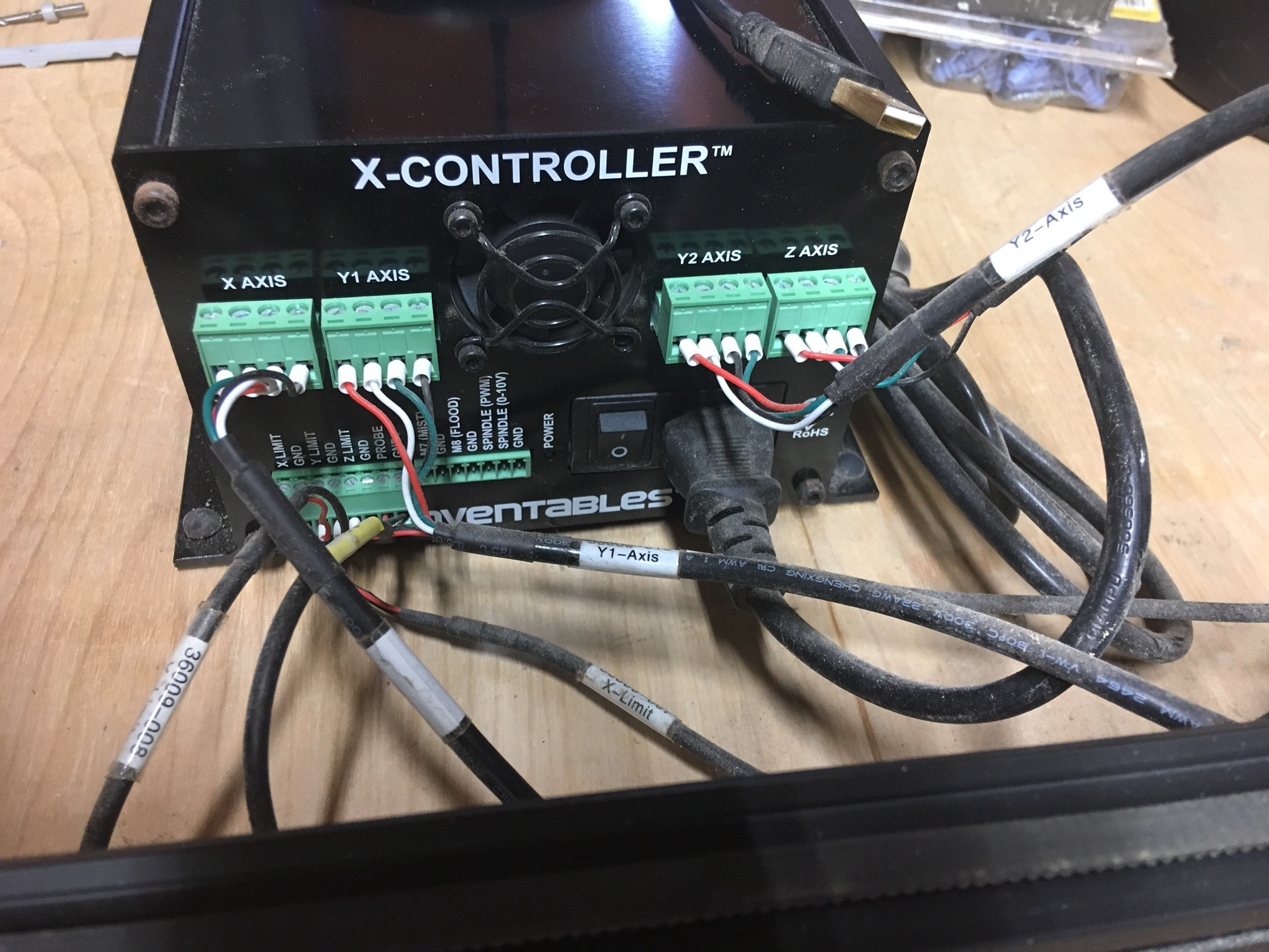

My issue was wiring. What was happening was that both motors were wired the same so that X was moving to the front of the machine and the Y to the back and thus binding up. Both motors were traveling in the same direction when they needed to move opposite of one another.
This is an image of the back of my machine. I have recently sold mine (I was under utilizing it but it worked fine) so I can’t provide any more photos.
All worked out fine when I wired them like this:
Y1 is wired: Red, White, Green, Black
Y2 is wired: Red, White, Black, Green
Hope this helps.
