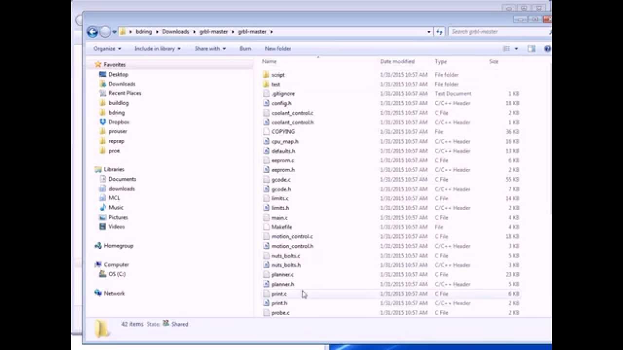

Thanks for your reply. I am more mechanical by nature after years of aviation maintenance so the electronics are a bit of a mystery, or magicland if you will. That being said, could you give some pointer on how to re flash the Arduino, please?

So I followed the video tutorial. It took a little while to get it right but it’s working now. But now I have new problems. The scale is off. I created a 10 inch by 10 inch example drawing and the carving was approximately 2.5 by 2.5 inches. I have checked numerous places to ensure my drawing/project dimensions were correct. How can I adjust the scale?
That sounds like the machine was set to mm and the drawing is inches. You need to be sure gcode is telling the machine to use the correct value. G20=inches; G21=mm
