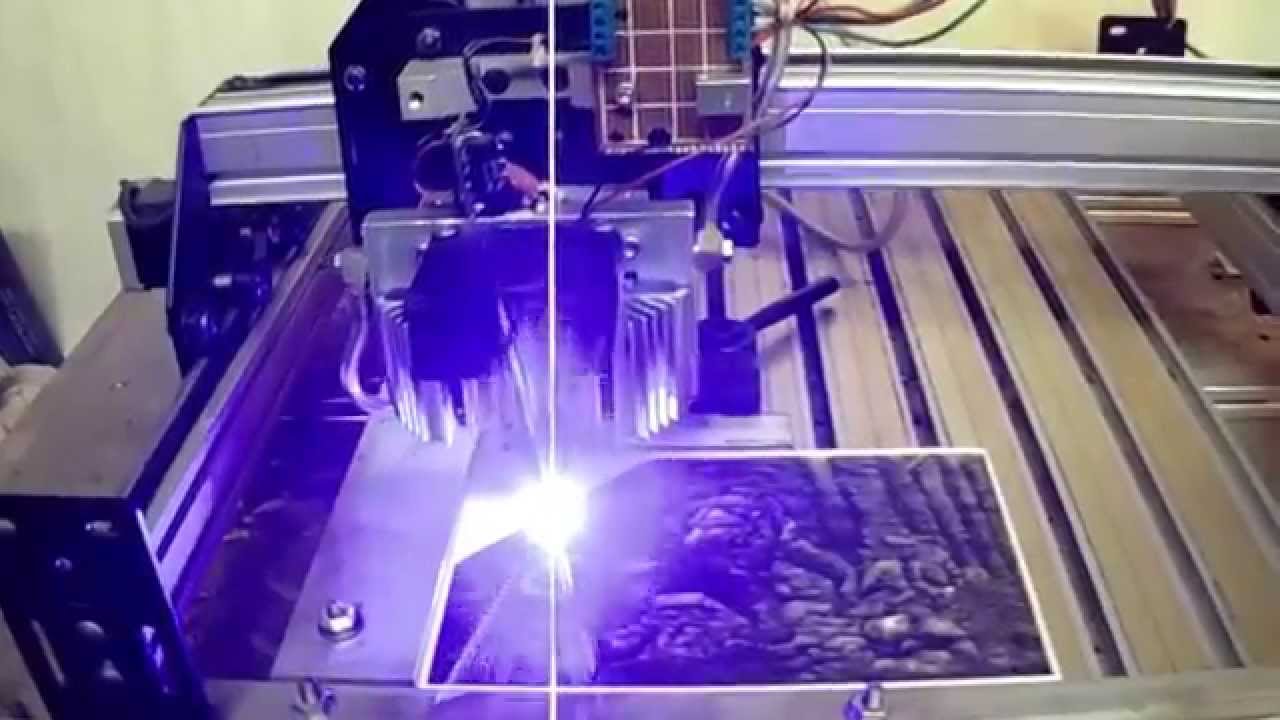

We have been experimenting with 3D laser Diode engraving here at picengrave dot com. We used PicEngrave Pro 5 to generate the gcode and cut into 1/4" Poplar board. The settings we used is a Pixel Resolution of .006" (step over and step ahead) and a set feedrate to 85IPM.
Our Feed Rate Change feature was used to expand the shades to the point it cut into the wood to different depths based on the shading in the image. With the 88% FRC setting we used, the black areas ran at 10.2IPM at full power of the Laser Diode and cut to a total depth of .125". This is not a fast process, but the detail we achieved with the Laser Diodes .005" focal point is amazing compared to doing this with a larger spindle rotary bit.

We just finished a new build on our Shapeoko 2 using a 6W 450nm laser Laser Diode from DTR. We were able to reduce the 3D engraving time almost in half compared to using the 2.8W 445nm LD. We are still refining the settings in PicEngrave Pro 5, but here are the results of a 3D engraving that just finished. It’s 7.875" X 5.25" in size with a.125" total depth of cut. We used the J-Tech grbl with S20-S255 laser power commands, a variable feedrate (Feed Rate Change) and streamed the 507,365 lines of gcode with our PicSender program.

Here is a 3D engraving using an Air Assist designed by us with a 6W 450mn Laser Diode. It’s made out of Delrin and is screwed onto the lens thread and seals against the laser module. There is a hose barb in the side for the air to enter and both the laser beam and air exits out of the tip through a 10-32 SS set screw with a .04" orifice.
I Gaussian blurred the image to smooth out the toolpaths, but I blurred it a little too much and lost some of the detail.
The gcode was generated with PicEngrave Pro 5 with a variable feedrate on each of the 737,935 lines of X,Y,Z & F gcode and was streamed with PicSender using grbl 9J.
The Flexmod P3 laser driver’s modulation is controlled with a US Digital 10bit MA3 analog magnetic shaft encoder driven by a nema 17 stepper. This setup allows me to switch from the Z axis stepper to adjust the laser’s focal height from the material, then switch to the encoder’s stepper to control the laser’s intensity with Z axis depth commands.
