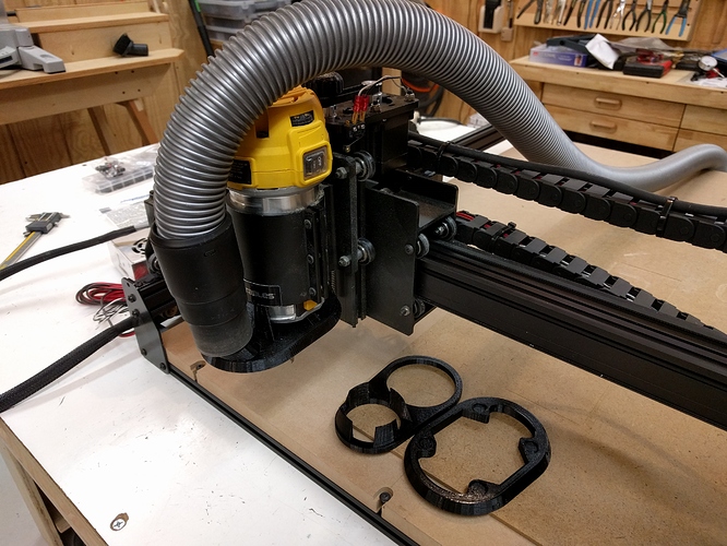

Overnight I printed the bracket in PETG plastic (should be pretty durable and less brittle than carbon fiber PLA, though with a shiny black finish instead of the cooler matte gray).
I am very happy that the hose connector fits my Festool 36mm non anti-static hose perfectly. The hole in the upper hose support isn’t wide enough for the connector, I’d need the hole to be 56mm or larger. Would it be easy for you to create a slightly bigger model?
I printed the dust body piece first to see if it would fit, that print took just under 4 hours. I printed the other two pieces together which took another 4 hours.

I printed the rest of the shoe over the weekend, but only carved a small thing to try it out. I was VERY impressed with how perfectly the brush fit into the bottom groove, it was a press fit and I suspect it would have stayed in place as is, but I put a dag of hot glue on the corners anyway. I suspect I’ll want to trim the brush a bit shorter, it seemed to reach below the longest bit that I have. The magnets I have were smaller than the holes you designed, so I placed them on one piece set in hot glue, then put wax paper over the first side, put the matching magnets on, then quickly filled the other recesses with hot glue and pressed the whole thing together so everything lined up. It worked well. During that one test I did see the bottom shoe move around a little from the force of the brushes, so I don’t know if that’s normal or whether I need to use bigger magnets for a stronger hold.
I feel that this is really close to perfect, the thing I didn’t like was that when setting home at the top/left/front of the stock I had to do this with the skirt off, then move it a known distance up and away so I could put the skirt on, then move it back. I was thinking of designing a skirt piece that had a hinge on the back and some kind of clasp on the front so the skirt could be put in place around the bit, snapped into the magnets, and the front clasp (maybe even a pin) engaged. My other idea was that maybe a notch in the back of the skirt piece that was just wide enough to let the bit/collet go through it wouldn’t be so bad, though that would weaken the skirt (maybe not a problem) and leave a small spot for dust to escape.

I think if you use the magnets I sized this for, you’d eliminate the sliding you saw. I’ve got the magnets just shy of the surface of the shoe and just proud of the ring, so the two interlock and can’t slide at all. It has to be pulled straight down to get it to release.
