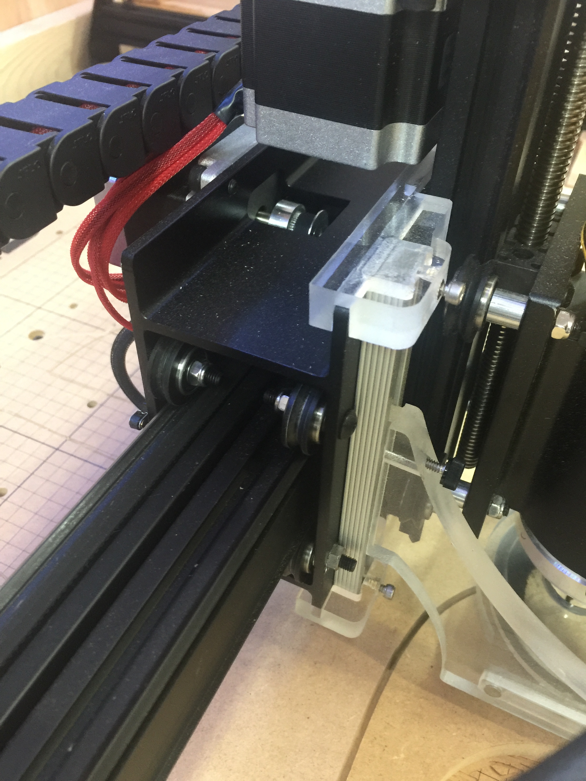

The picture of the x carriage, the top left v-wheel in the pic (non eccentric nut) spins freely accept for when it gets close to the ends of the x axis’s. All other wheel are tight and i can’t really spin them .
Im under the assumption this may be a part of my issue but maybe not. either way it needs to be fixed yes? how do i go about doing that efficiently…loosen all wheels and re tighten all wheels?

First; Make sure you followed this link to see if you miss something.
Second; check to see if your wheel spacers are installed correctly, maybe V surfaces are not sitting to maker slide correctly.
Third; turn your machine off, bring your X axis all the way to the edge which you think it’s getting tighter. Loose four screws holding maker slides, check your V Wheels if they’re free to spin. Tight those screws back again, adjust your wheels evenly (small amount per eccentric at a time).
Now push your X axis to center, are your wheels getting looser ?, then you need stiffness mode to make two maker slide straight enough.

I then checked the wheels on the gantry. When its all the way in the home position front left corner. all the wheels are tight and can’t really be moved with one finger but with two you can move them. As i send the gantry across i can watch the one wheel no longer spin and its almost as if it looses connection with the x axis. All other wheels move in synch.

Checked all my set screws and they were all tight. It’s funny cause it’s slowly been getting bad. I will do the fixes to the x carriage that the others have stated to do to fix the v wheel problem. … anyone have an idea why one of my y axis motors seems to have a clicking noise that comes from the pulley? While it’s moving I placed my finger on the pulley as it rolled and when it clicked I felt it. Seems to be rolling fine and nothing in the belt or on maker slide… any concern there?
I had a similar issue. Quality getting worse and worse. It turns out for me, the hole for the eccentric nut on the Z axis was getting stretched out, causing the z axis to shift under load.
So something may be wearing out. I would just keep checking the v wheels, it could be a bearing issue?
