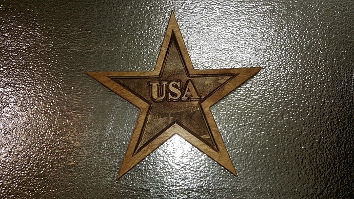

I don’t know why I installed the switches? Thought it was the right thing to do. But now that I think about them. I never used them on Easel. LOL How do I disable them?? Also, GREAT!!! News… First tool pass went just fine. Now I have to change bit. Question, Do I have to go thru all the zeroing again?
After the first pass completes the X and Y will return to exactly the initial zero you sent them to. If you change the bit without manually (I mean pushing not jogging) moving them then they are fine. You will need to re-zero the Z since the new bit will not be sticking out exactly the same amount as the first bit. So change the bit then re-zero the Z.
When you are re-zeroing the Z you should be able to tell that your X and Y are still in the corner as you first set them,
Yippy!!! First project successful. I don’t think it’s too bad. Ten foot away, it looks great! lol. Thank you VERY much for getting me over this little bump.
Well, You’re quick or what. You were asking questions less than three hours, now you’re showing great piece of work, also finished with stain over shellac. That pocket is made by .128" Ball head bit, Profile cut out is .128" 2 flute spiral. In 2 hrs and 30 minutes. Impressive.

The X-Cave is a very capable machine. Anyone that wants to spend a little (ok, maybe a lot) time can learn to make some awesome projects. Good work Jene, I am glad you stuck with it had had success.
Thanks again. Looking forward to many more enjoyable projects.
