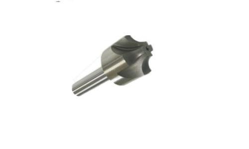

You would probably have best luck with a corner rounding endmill instead of 3d tool paths much quicker
Here is a link to a .375" corner rounding endmill so all you would have to do it carve flip then carve
So it seems that possibly the X-Carve is not suited to this operation if it needs to be done without flipping the material. Currently I use a bullnose router bit with a bearing in a router table with a template. I was looking for a way to do this step in one setup step while working on other parts of the process. I can raise the top off the surface easy enough for clearence but am not finding a similar style bit which would fit in that Dewalt router.
That corner rounding endmill will do it in one step along with a custom made router bit or shaper on your router table

So it looks like this bit might work, though a little close to the 3/4" thickness of the material. But it would cover the entire span of the edge with around edge.
this one is more the traditional bullnose
http://www.woodcraft.com/product/123297/whiteside-1428-half-round-bull-nose-router-bit-14-sh-14-r-x-12.aspx
And yes, @MidnightMaker, I am sure the feed rate would have to be slow to avoid chatter. I’ve had good results with the router table but am looking for a way to make this process more efficient, time-wise. Sanding and buffing screw-ups is no fun!
In order to get the full bullnose profile on both top and bottom with the same pass using one of the bits shown, you’re looking at two challenges at least. First, the bits will dig deep into the waste board and second, you’ll have a clamping challenge since you’ll be cutting the entire perimeter in one pass. Therefore, you’ll probably need to screw down through the board somewhere. The good news is that you won’t need to flip and rezero.
