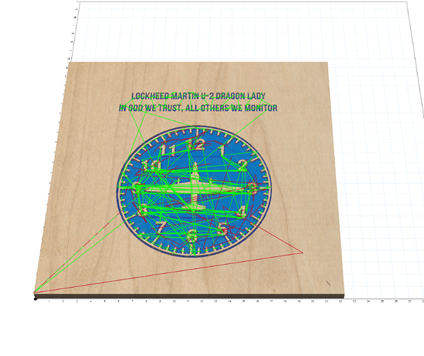

Another crappy cut
And ran it again… This time the first project is different than it was a few mins ago. I have moved nothing.

I have seen this before. There is an object left at that point. I have had that happen to when I first got my machine. I removed everything or so I thought but an object was still there. Try zooming in and see if you can spot it
Looks like clear toolpaths now. Did you guys do anything to the design or Easel to correct?
Hi @PaulRinguette, could you please wait a bit before carving. I think there is a toolpath problem in your project. We will identify a fix and get back to you

No problem. I would like to carve tomorrow but only if there is a fix. Also, I would like to know if this is self inflicted so I can avoid it moving forward.
Hi @PaulRinguette,
We had to revert the fix, due to another issue. Our fix was a mistake because we wanted to get the fix out quickly and we rolled it back to do a slower and methodical fix. I will update this thread.

We have deployed a fix again. Please check.
It was not something you did. It was a bug in Easel.
Is this a fix for my specific issue
Yes.

The simulation looks good and was fast(er) than before. I will look at it in detail tomorrow and if it still looks good will run it. It’s about a 6 hour job.
Just finished the entire carve. Took about 8 hours but I did it slow…
Came out great! Thanks for fixing the issue.
