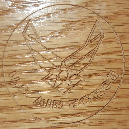

I started a new project on make lettering for my neighbor who is working a flag box for his father Richard Kibbey (more about his father at JOLLY GREEN 05). I carved the USAF logo without any problems (see photo). I carved the circle without any problems. When I started on the lettering for the call sign “Jolly 05”, I had a problem. It cut only “Jol” and cut the rest of the lettering in air (see and photos).
I have some video of it cutting in air if that would help any one. Looking at the Jol lettering, the lettering is jagged in the X and Y axis. Yet, the circle cut before this is true shape in the x and y axis.

Yes, I am running UGCS version 1.0.9 / Nov 11, 2015) and grbl 1.6.9 flashed on the Arduino. After your post, I found a link which describes what you are talking about the upgrade I need to do (ref Grbl version 1.1f requires updated G-code senders). Thanks LarryM
I was able to upload and extract UGcS Version 2.0 [nightly] / July 23 2017 from url address Download - UGS. I’ll let you know if I have any additional problems.
I was able to get some time today to make a test run using the UGCS version nightly 2.0. The total cutting time was less than 15 minutes and I did not have any drop outs in the Z axis. Here is a picture of the final cut on soft yellow pine with a 60 degree V Carve, 40 ipm, 15 ipm, 21K rpm, and depth of 0.04 inches. I think I have everything resolved. I’ll post a picture of my belt on the Z axis in another thread to see if the belt is causing drop out if I have cut that are 30 minutes or longer. Thanks for the help.
