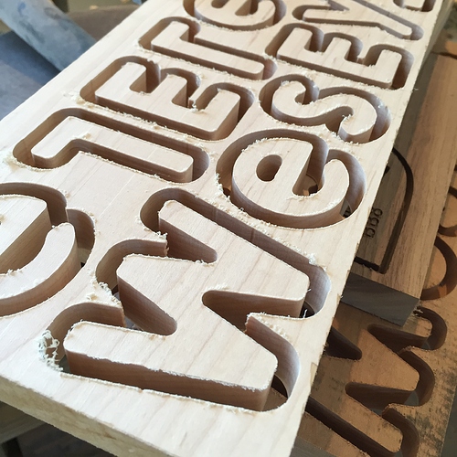

As to the straight over the spiral, the only reason to prefer spiral over straight is because of the chip removal, otherwise the straight bit makes a cleaner top edge (way less fuss) and smoother sides and bottoms. With the spiral bits that have the wings you tend to see circles on the bottom of pockets, but straight bits wont leave these marks.
The only drawback is that a straight bit won’t remove the chips, so the bit will overheat and dull in a matter of minutes if you are doing a deep profile cut. But with a good dust boot and vacuum you can overcome this.
Here is a photo of a cut with a spiral:

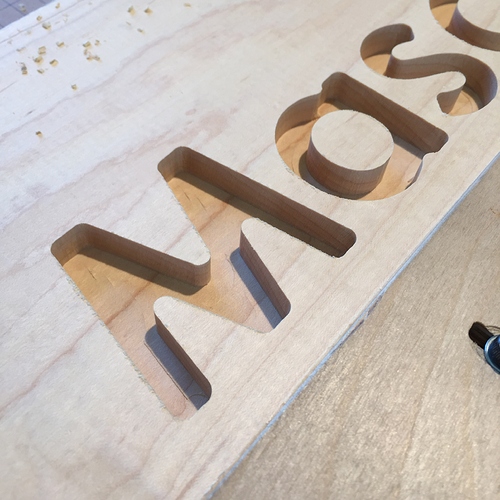

This is with a straight, made possible by the SuckIt, and it worked great!

Thanks for the info. I don’t cut mdf at all. All I cut is plywood since I get a lot of left overs from work. And yes, theres is a big difference in those pictures. I will look around and get some because I really wanna try them just to see the results. I have a descent dust shoe so I think I will be fine on that part. Thanks again for the information and those 2 pictures Joseph !
