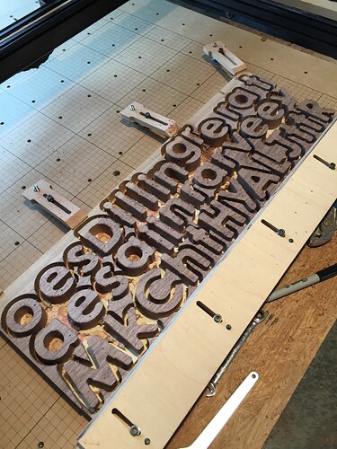

Here are a couple of photos of some of the stuff I do.
The bit you are using looks perfect for what you are doing. Keeping the Dewalt RPM low like you are doing is definitely the correct thing to do. If I was doing that cut I would keep my feedrate at about 45 ipm and my doc at about .1 inch
The other thing I have learned is that when making deep profile cuts it helps if the width of the cut is about 1.25 times the diameter of the bit. This keeps the bit from binding when it is deep in the cut.
I wish I could run it at that speed. I’m usually around 30 imp at .03 doc.
The photo of the pocket cut is actually a two stage cut, first with a 1/4" then getting the smaller parts with an 1/8" bit. This was my first two stage cut and I was happy with the finish product, I just wish it didn’t take so long.

I would strongly suggest the x and y axis mods. A steel plate or aluminum t between your rails and also bracing for you y axis.
That bump is probably from flexing when your bit plunges into the material. The mod is very easy to accomplish and you will be thankful later. Also, I use a much larger Hitachi router on my 1000mm machine which has more mass and horesepower and I am still on my first set of brushes after 4 years.
For cutting out your letters, try using an 1/8" bit. It will apply less force when plunging and you will get better detail. I would not be surprised if you could run it at .08 - .1" depth of cut and 30-40 ipm. Also, try to find a “downspiral” or down cutting bit. Try to find a bit that has a cutting length equal to but NOT greater than the maximum depth of cut. The less bit that sticks out the better your cut. Your letters will be much cleaner.
Also, I use V-Carve Pro so I am ample to “Ramp Plunge” into my work and create “Ramped Tabs.” Both help create more accurate shapes and easier clean up afterwards (especially with a down spiral bit). I am not sure if those features are available on Easel.

I think deflection is a definite problem and I have read through the Stiffening Mods threads a few times already. They are fraught with people trying things and offering suggestions and some people doing things and saying why it worked and how it could be better. It would be great if someone just wrapped up the thread at the end saying “this is the best way and this is how you do it.” Maybe it’s in there, and I just get lost. The other side of it for me is I’m hesitant to make a change because I can’t waste time with the machine being down. If I make an adjustment and it upsets my cuts I’m throwing money away and I’m adding to the pressure of how far behind I already am.
But I’m ready to bite the bullet and do the mods, so I will try to find the correct measurements for the thickness of the metal and get it ordered. I already bought some brackets for stiffening up the y rails and I know this will help I just hope I can get it accomplished without mishap.
It’s has been difficult to find a 1/8" bit that will cut through 13/16" material. I have one, but it’s not really for wood, and according to the Amana customer service it’s the only one the carry. Inventables offers one in a straight flute rather than spiral and maybe that’s worth trying. I would use less material and get better defined objects if I were able to use a smaller bit.
I went with an up cut spiral because it’s seemed like a good choice when cutting deep, so that the material was pulled out. With a down spiral don’t you risk heating up your bit as the material is not ejected as effectively? When my bit is sharp, I am actually really impressed with the finish. There is fraying at the top edge which increases as the bit dulls, but we round all of the edges anyways in the finishing process, so that our products are really smooth for young children, so the fraying doesn’t have much effect. We belt sand, orbital sand, and mop sand everything. It’s part of our business model and why we have done so well, our products are a pleasure to hold in your hand.

As for what you are cutting, just order 1/8th bits on Amazon. Two flute, .75 cut depth, 1/8" shank and you will be fine. If you are finishing the top edge anyway, then up cut is fine. Once your machine is dialed it, you can use downcut or compression cut (combination) and it will be fine.
