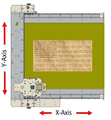

I have a bobscnc evolution 4 and you probably know he has x and y set up backwards. Can someone help me with step by step directions on how to switch it to how normal machines work please. I defiantly mean no disrespect for the company, it’s just not how I want to use the router. I use easel pro to design my projects and UGS to run the machine. The router is stock.

It’s a grbl but it has a self squaring gantry with two steppers and the x2 and the z limit switches are wired together. It has to have the software changed also somehow. I think lol.

This is how he wants us to use it. Sideways. I want to set it up so the gantry is to the back not the side.
Do you want the dual axis feature?
If so, just swap X and Y at the board and use grbl with the modifications I mentioned above. If not, you can just swap X and Y at the board and adjust the jumpers to clone the Y axis on A.

You’ll have to upload new firmware if you want X & Y to be as they should. Yours is setup do do the autosquaring on the X axis…you will not have good results. You’ll need to download grbl and change the config. I can give more details later.

Yes I would like to keep the auto squaring if I could. But be gentle with me on uploading the firmware. I have never done anything like it before.

In the Config.h file, before you load to your arduino, you’ll change:
// #define ENABLE_DUAL_AXIS
to
(just remove the slashes to uncomment)
also
#define DUAL_AXIS_SELECT X_AXIS
to
#define DUAL_AXIS_SELECT Y_AXIS
You’ll comment line 662 with two slashes so it will look like:
//#define DUAL_AXIS_CONFIG_PROTONEER_V3_51
And you’ll uncomment line 675, so it will look like this:
#define DUAL_AXIS_CONFIG_CNC_SHIELD_CLONE
Save and then upload as explained in the link above.
Then, without power…
You’ll want to switch the X & Y stepper connections and limit switches at the board.
Power up and test the X & Y movements before you try homing or anything.
Good luck!
