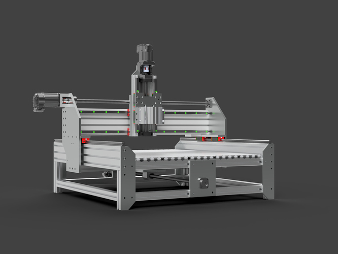

Building B-Carve
And here’s a rendering.

She’s a beauty Elias. Following as always… What sort of extrusion are you using for your x and y?
This is all 30 system (30mm base size, 8mm slot). I had enough T nuts and brackets already and could reuse the existing extrusions, with very few additions.
X gantry: 60x120
X crossbeam: 30x90
Y walls: 30x90
base: mix of 30x30, 30x60, 30x90
bed: 15x120

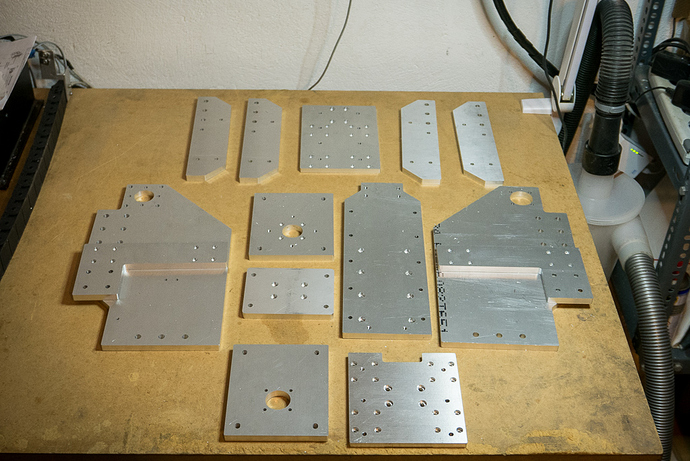

So, here we go. I cut a couple every night for about a week.
Foot plates, gantry plate with ballnut location moved to top, side and L plates for joining X to Y, taller Z plate, spindle plate for four blocks, front & back Y bearing plates, and a little crossbeam plate. Out of 10mm 6082-T651

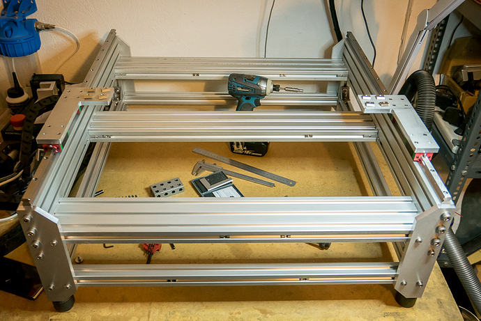

Top part of base.
(Too much detail #1: The four short 3060s are not that important structurally. It has to do with settling on the final base width, taking into account the width of the bed pieces. Previously I was using 6 pieces, 120mm each, 720mm total. Given that the Y sides are now above the bed surface, keeping 6 bed pieces would bring the total width to 780mm. For the rigidity reasons discussed earlier I did not want to go over the original width. On the other hand 600mm wall-to-wall would mean losing 120mm of X travel, which I did not want either. So I settled in the middle, 660mm, 5 bed pieces and these short 3060s to fill the gaps. They can also serve for work holding by using post-installation nuts.)
Btw, there are hidden corner connectors that hold the the 3090s together.
I was too lazy to draw these in the model above: rubber feed with M8 threading for leveling and to help with absorbing vibrations too. Nut and washer for tightening.
Base assembled. The Y rails are still loose and so are the Y bearing plates.
At this stage I wanted to confirm screw lengths and quantities. I ran out of DIN912 ones (deeper socket, bigger size allen key => can take more torque) and had to use some temporary ISO7380 ones.
(Too much detail #2: The temporary ones were used on horizontal slots, so they could be easily switched out. Had they been used on vertical slots, that would have resulted in dropped nuts, fishing, face palms and lots and lots of cursing at switching time).

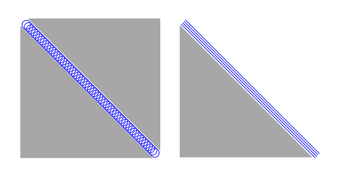

I also tried something new this time to save on cutting time on far-from-rectangular pieces (e.g. the big hypotenuse of the side plates). Previously I’d make a quick sketch, project the part, create an offset and cut trochoidal slots inside this channel. This time I got a multipurpose blade (54 teeth, negative rake) for my small circular saw (no space for table saw), print out a drawing of the part, stick it on the stock, then cut off the big chunks. Then I used the same offset sketch, but this time as “stock contour” in Fusion. A lot faster toolpath, as the former spends half the time repositioning.
UPDATE:
Here’s a visual of the above comparison.

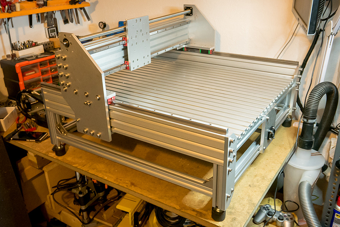

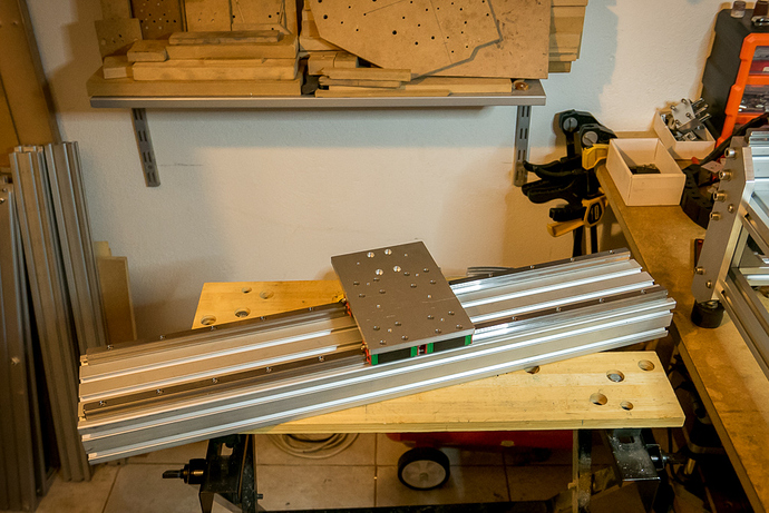

Fox in socks on box on Knox. (gantry plate on blocks on rails on gantry extrusion)
L plates on Y blocks.
Gantry on L plates.
Side plates, gantry and L plates bolted together.
There’s a shallow groove machined on each side plate, not just to help mate with the L plate, but to assure squaring/alignment.

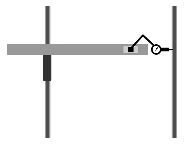

I didn’t think to take a picture of the X and Y calibration, so here’s a drawing instead.

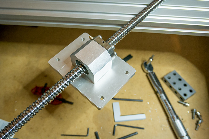

X is straight forward. One rail is fixed parallel to the extrusion, the other is loose. The dial indicator magnetic base sticks on a rail block and the indicator travels on the precision ground face (the one marked with an arrow) of the other rail.
Y requires more creativity. Again, one rail is fixed parallel to its extrusion, the other is loose. Both rail blocks are fitted on the fixed side with the L plate on top. I then used one of the old gantry 3060 extrusions as an extension. A 1-2-3 block is bolted close to the edge to give something for the indicator base to stick to. The indicator is slowly moved by holding the L plate only. Nothing else gets touched.

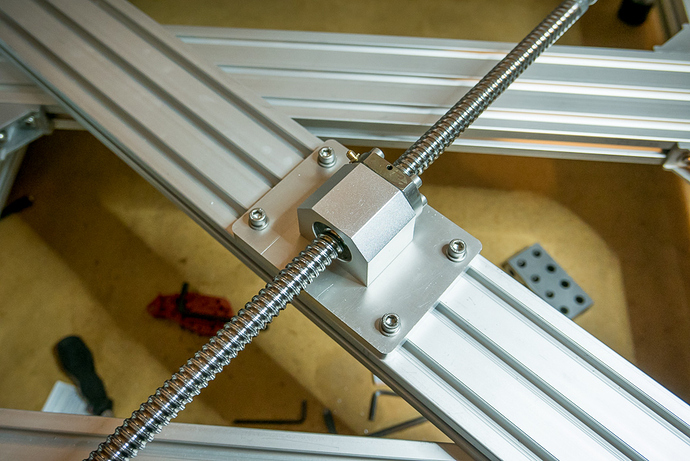

Y ballnut mout on crossbeam plate. Squared and tightened.
Crossbeam plate on crossbeam. Loose.

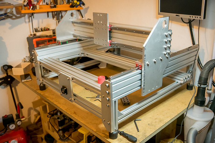

Crossbeam fixed between side plates. Y bearing plates fitted loose.
Looking from the front (XZ plane) there is +/-1mm adjustment range on Z and plenty on X (the whole extrusion slot). The order that provided the best alignment was: move gantry to the +Y end, fix crossbeam plate, move gantry back midway, move to +Y end again, fix +Y bearing plate, move to -Y end, fix -Y bearing plate.
Looking from the side (YZ plane) there is +/-1mm adjustment range on the Z and +/-0.5mm on the Y. Similar order for alignment: gantry to -X end, fix ballnut mount on gantry plate, retreat midway, back to -X, fix -X bearing, move to +X, fix +X bearing.

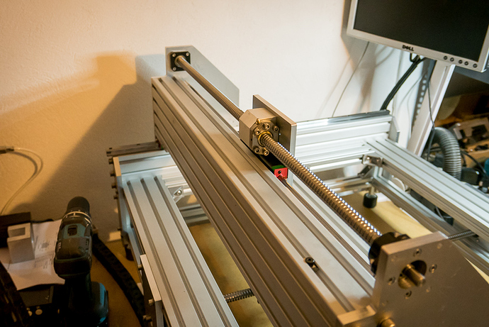

Bed in place.
All moves at this stage were done with a cordless drill. Otherwise at 5mm/rev it would take forever by hand. The cordless drill also helped verifying that everything runs smooth. This was done at its high speed (1500RPM or the equivalent of 7500mm/min).
Good to see that the high mounted X ballscrew is performing well, high above the chips it will stay clean too.

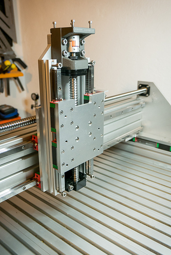

…aaaand here’s the Z.
Nothing new here. Just a bit taller than the previous for a second pair of blocks to fit without losing any Z travel. Build process same as in post #195.

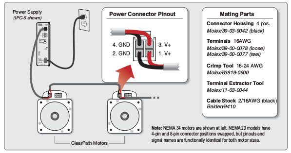

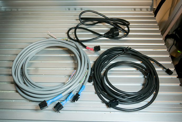

Made some cables. The connectors are:
8-pin Mini-Fit Jr (signal, motor side)
4-pin Mini-Fit Jr (DC, motor side)
2-pin Sabre (DC, power supply side)
8-pin Mini-Fit Jr (AC, power supply side)
The power supply has two DC ports. One will go to the Y motor which will be doing the heavy work, one will go to the X & Z in daisy chain. This works well with cable management too. Here’s the relevant excerpt from the manual.
