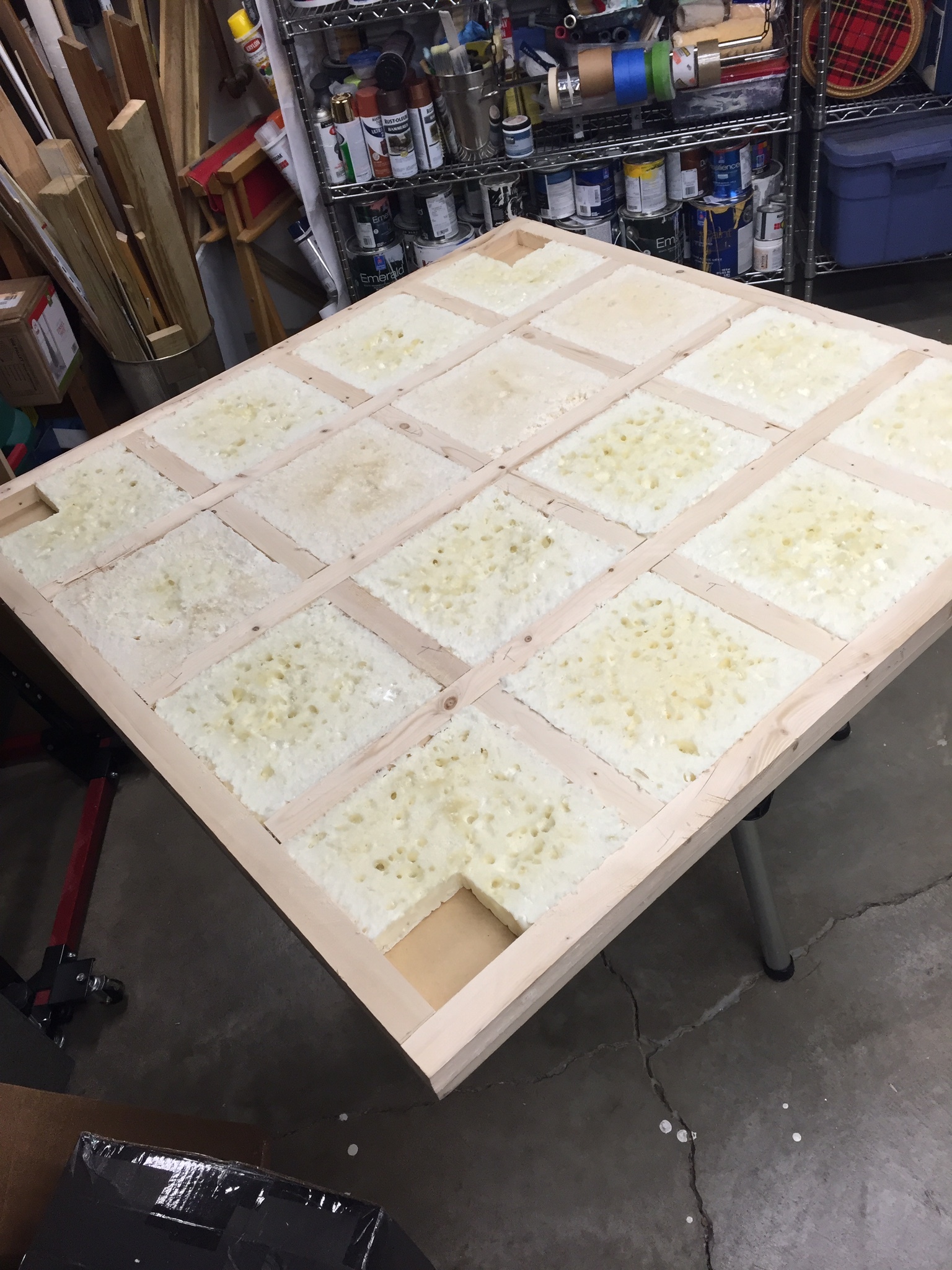

Theoretically you could skip the bottom surface but in my experience it really adds lots of rigidity. Some people also fill the voids in a torsion box with foam. this only marginally improves rigidity but does wonders to reduce resonant frequencies of the box. I elected not to fill voids and have had no issues with resonances (they won’t impact carves, but just add to the noise)

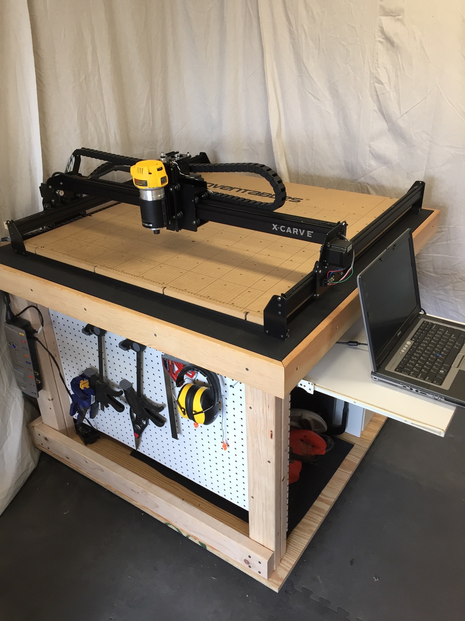

My definition (and anyone can chime in on this) is basically a sandwich. Flat material on the bottom and top and stiffeners in between. I used 3/4" MDF cut to 44"x44" for both top and bottom and used 1x’s trimmed to make them all equally sized as the stiffeners in between the MDF pieces. I then went an extra bit and filled the cavities with spray foam to minimize any hollow sound or vibration. A picture is worth a thousand words:
This photo is obviously before I screwed the top on. I then added doubled-up 2x4 legs, a bottom shelf, some pegboard sides, a laptop drawer, a 1/4" thick rubber mat surface, a drawer unit from IKEA and leveling casters to make it all pretty. There’s also a little hidden shelf under the back edge for the electronic components to keep them out of the way.
You can do it! And the support here in the forums is second to none.
HTH.
That looks really good! And looks like something I could make! What did you use inside as braces? 1x2s? Also did the spray foam add much weight? Thank you guys so much for all of the detailed information! I am not as worried now after that.
yes sir thats all it is, i didn’t fill mine because i didn’t think i needed to

Here is the table and internals I built for my machine last year.
There are three internal braces that goe from one side to the other and the rest is just smaller blocks fitted into the space. The intrnal bracing is glued and nailed together inside with an 18 gauge brad nailer and it has 1/2" ply on the bottom and a 3/4" MDF top was installed after this pic was taken. The bracing was also glued to the top and bottom panels. Solid as a rock, you lift one corner and the whole end comes up with no twist. then I covered the thing in two coats of shellac to seal it. It is a bit of overkill but I had the time, materials, and tools to do it so…
The enviroment I live in ranges in temp from 90+deg F in the summer with high humidity to -40 deg f in the winter and so dry that a desert would look humid by comparison. I have noticed no appretciable twist or warp in the table.
Unless you are making hyper-accurate parts for an oscillation overthruster out of unobtainium, somthing similar to this should more than suffice for your machine.
