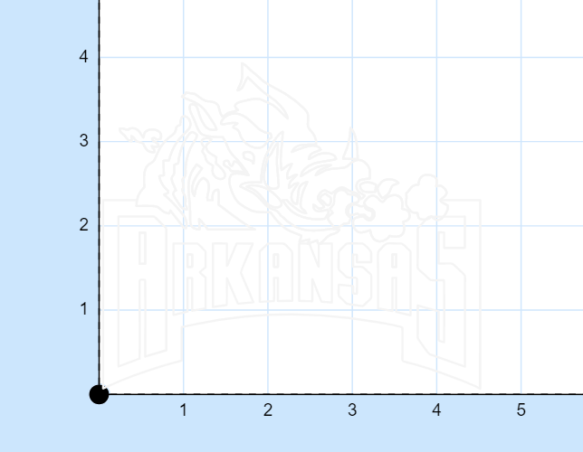

I just put my 1000mm xCarve together a couple weeks ago. I created an SVG file in Corrl Draw and imported it into Easel. I Homed the xCarve, secured the board to the washboard, used the probe to set top of material, set the start position to the lower left corner of the board, and started carving. The entire image is shifted up and to the right about 1.5 inches in each direction. The image in Easel is in the lower left corner of the page and the preview also shows the image in the lower left corner of the board.

The image is the correct size. just in the wrong place. here is the link to the project:

I am confused by the quadrants and the position of the image. Easel shows a 0 for X and Y position in the lower left of the work area. The preview image shows my work piece and the image to carve on the work piece in the lower left corner of the reachable area. When I select a new start position, I expected that point to become the new X0Y0 and the lower left corner of the image to st start carving in that exact spot. But, the actual image is shifted up about 1.5" and right about 1.5"

So, I did a bad job of scientific experimentation. I changed 2 parameters at once. I recreated the image. In Corel Draw, I am able to export an SVG in either version 1.1 (default) or 1.0. A changed to version 1.0. So new image and new svg version.
Good news is, it worked perfect. Carved the image exactly where I wanted (and expected). Not sure if it was the new image or the 1.0 version of svg.
