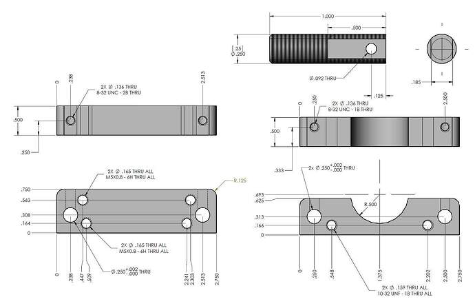

Well I just finished chain drive conversion similar to Jerry Brown’s. I also just purchased a Gatton CNC kit, so I am thinking of selling my X-Carve - decisions decisions…

Also I’ll attach the files that were used to build the sprockets…
This upgrade was designed by Richard Moller of shadetreecnc and I had my buddy Juan Lopez, from gcodeonedesign, help cut out the blocks using aluminum…
There is a few things I had to do different here, as the sprocket holder for the xrail was to thick at .500 I had to trim it down to .400. I also used simple eye bolts to attach the chain to the end caps… I did have to drill new holes, but not a big deal…

Ok so i didnt use the Delrin as i had my buddy cut mine from aluminun and I used eye bolts from the HD to secure the chain to the holders… and new holes needed to be drilled… Ill attach photos in a few… I had to grind the eye bolts down just a hair to fit in between the chains…

2737T1 9 Tooth 1/4" Bore For #25 Roller Chain
94803A029 Push Nuts 25 Pack
60425K130-10 10 Tooth 1/4" Bore For #25 Roller Chain Nylon Gear
95648A680 Captive Dowel Pins
8662k41 Material for Idler Blocks .5" x 1" Black Delrin (to make your own sprocket mounts)
Amazon Chain #25 x 10’
Amazon Roller Chain Connector Links
Amazon Chain Breaker
Just make sure when you attach the chain to the ends that everything is in alignment… you dont want the chain bent…
