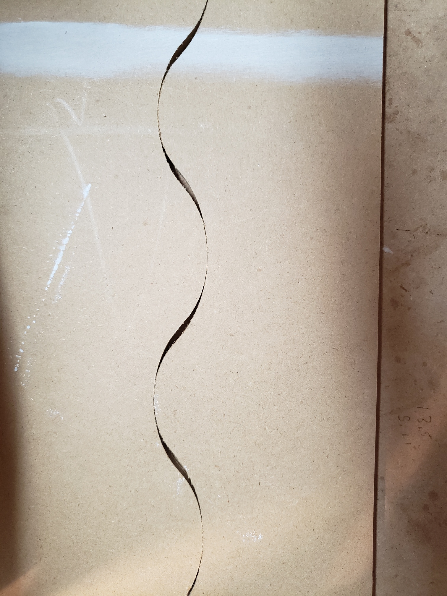

im just trying out a design for someting but its not working out. What am i missing? This is just one cut ran in the middle of the toolpath, cut from the same piece. There are consistent gaps on one side of the arch. Is this some sort of run out or miss calculations.?

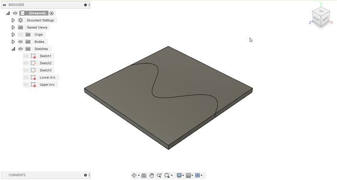

@TerryNicholl I created a model to hopefully explain what you’re seeing. By cutting on a path for both sides of the cut, you will never be able to get them to mate completely due to the kerf of the bit. If you want them to mate you need 2 cuts, one on the outside of the path and one on the inside of the path.
@TerryNicholl This easel project was made from the example file that I have been taking screenshots from. Both should need to be outside cuts in order for them to mesh up. Note - No tolerance has been added and these are size for size.
@TerryNicholl I think there is something wrong with the imported DXF and it may be cutting on path instead of outside path (even though Easel is saying it is cutting outside of path).
