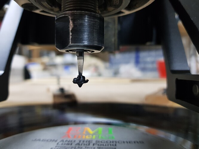

And I’ve tried a lot of difent bits,
but it will only be as the pictures are shown
I have tried different speeds and different depths,
but the result will be the same every time.
In the pictures I have used 100 ipm and 75 ipm
Use an upcut bit, instead of an engraving Bit, but please use the search section to find more information about this topic because I’m not well-versed in this and are many topics about this
Blow air on it to help keep it cool. keep upping your IPM would be my second suggestion, maybe with a increase in RPM.
Vinyl is really soft to work with. Imagine carving a stick of frozen butter with a warm knife. Too slow it will turn to mush.
If you were carving CCW I’d say too slow, if CW your plunge rate is too slow. (the lower right looks closer to desired results) Maybe fast IPM with a shallower cut and more passes.
What are your current GRBL-settings for these Kristian:
$112= ? $120= ? $121= ? $122= ?
Also, what is your router RPM?
While your feed rates may be fast you may be slowed down by conservative acceleration rates when doing complex curvature. If something melts during carving reduce RPM and/or increase feed rate.
The records is about 1,8 mm thick and I set the depth the first time
at 1.8, no luck, second time 1.5 mm , no luck
And I tried several time with starting depth of 0.5 mm up till the end 1.8 mm
same results
