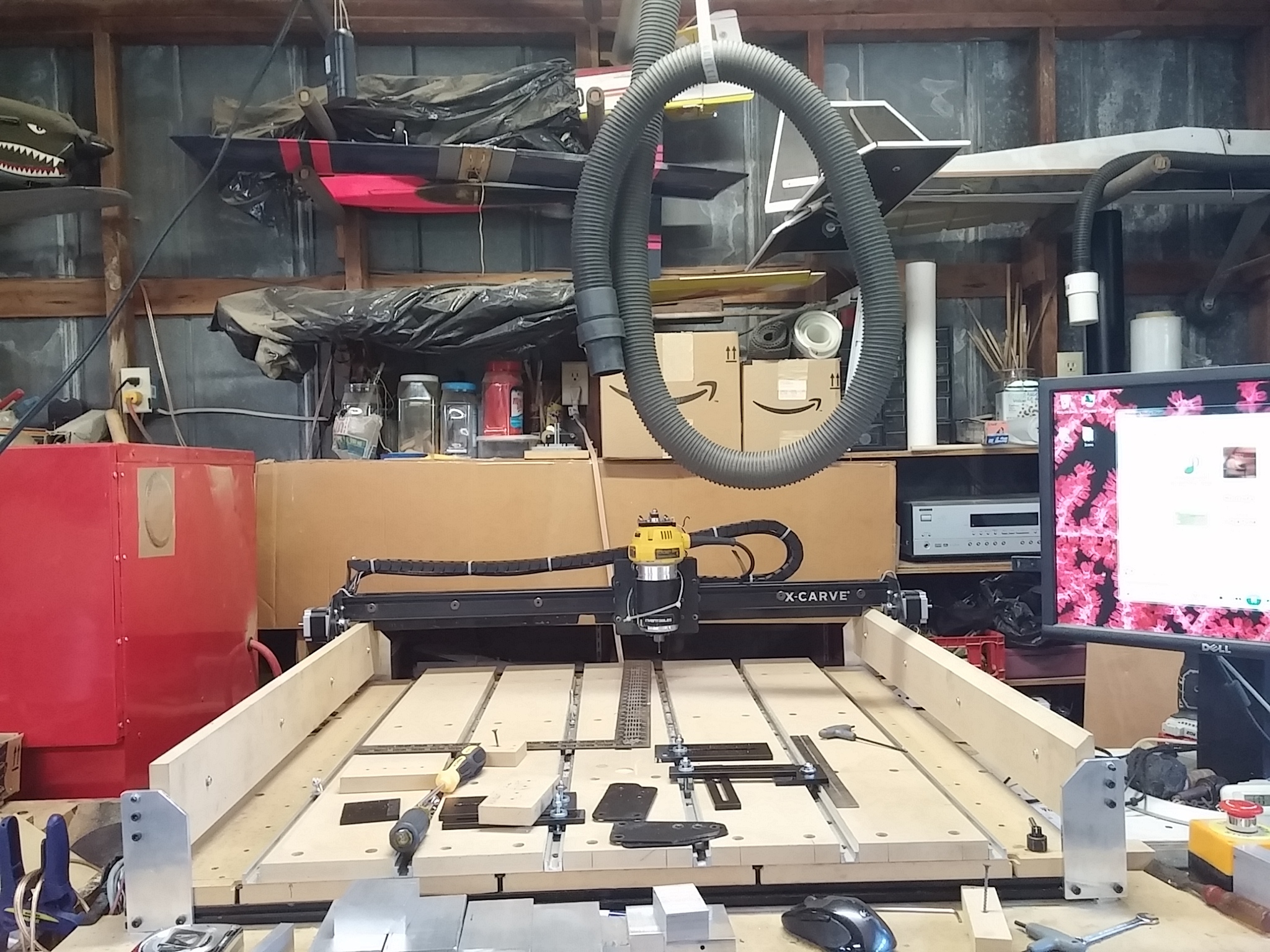

Pictured below is my dust collections plumbing. I ran PVC pipe through the wall to my dust collector to abate the noise of the shop vac. The white strap holding the hose is just a strip of elastic. I loop the hose through the elastic to take the weight of the hose off the router/X axis.

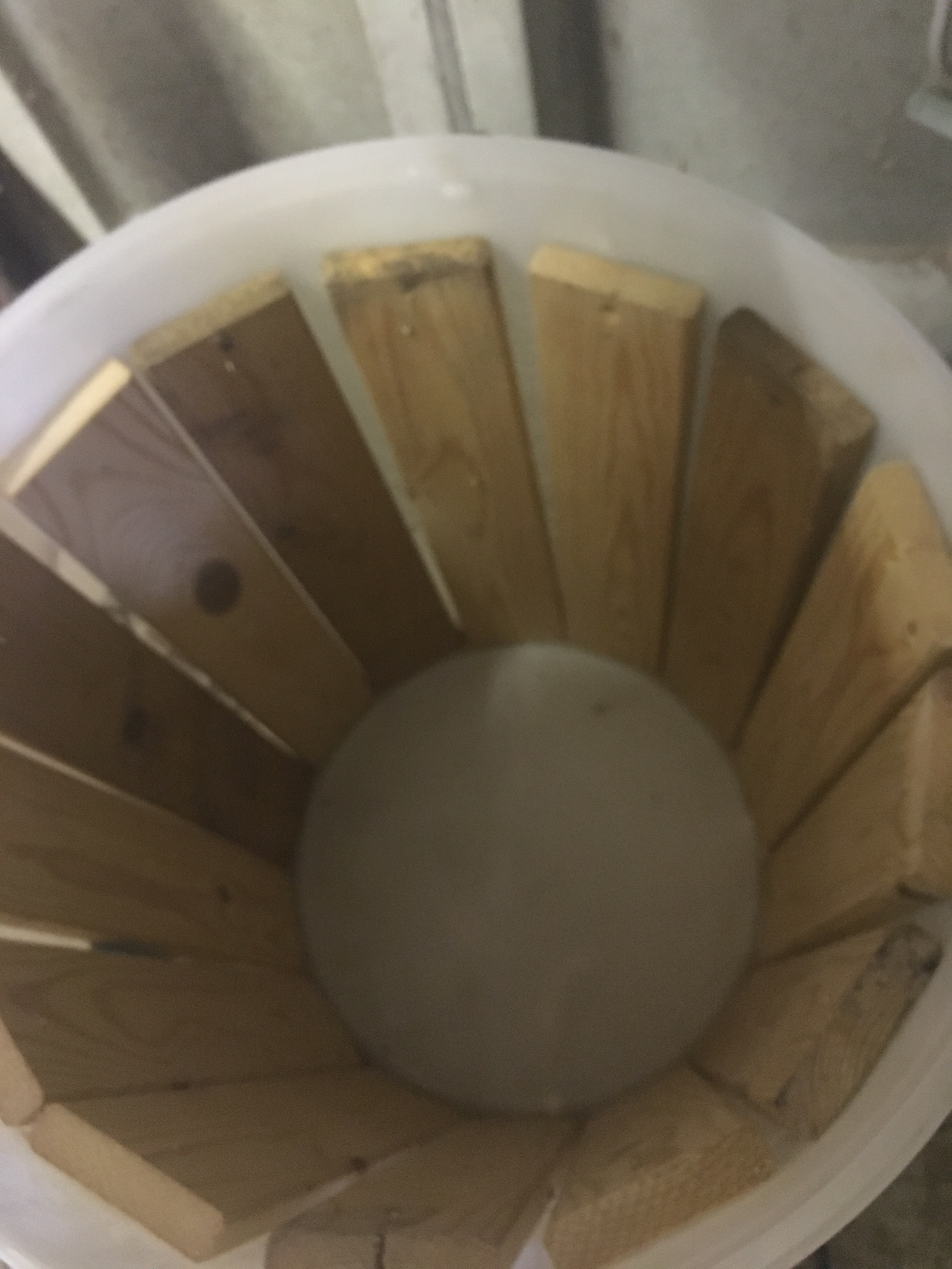

I’ve upgraded my bucket, looks more like a Swedish sauna than a bucket now but hey ho.
Now the bucket doesn’t collapse … the cone does. So external bracing for the cone is the next addition. I then need to get some PVC pipe and make some blast gates, pipe round my (very small) shop to my other tools.

[quote=“CharleyThomas, post:11, topic:26457”]I loop the hose through the elastic to take the weight of the hose off the router/X axis.
[/quote]
How well does the elastic work? I was going to use a spring for this purpose, but elastic might just be easier to set up.
I use a bungee cord from the ceiling to hold the hose.
Wow, that’s an excellent idea Erik. Thanks!
I was going to use a bungee cord but didn’t have one handy. My wife gave me the elastic and asked if it might work. Much to my surprise it works very well. I have one end permanently attached and a simple spring clap holding the other to make the loop. I just move the shop vac hose through it until it connects to the dust shoe with little to no weight on the shoe.
