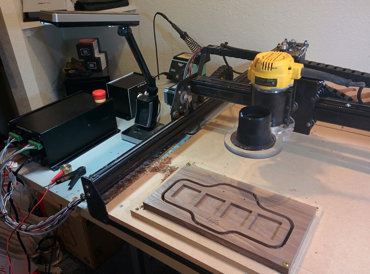

Success! My first carve using the X-Controller!
This is one of the bases for the Massdrop project I’ve been working on, and is #28 that I’ve cut, so the program is very well-tested and proven. The X-Controller presented a few challenges in using the Z-probe, for some reason it needs the probing cycle to run twice to give a proper reading. I’m not entirely sure why, but the first probe cycle results in a value that is much higher than the position of the cutter tip. If I run it a second time directly after, it will give the correct reading. This held true through the testing, and through the production part run. I am running both the probe and the cutting operation with ChilliPeppr. Aside from that, there were no surprises. The program ran just as smoothly here as it did using the old controller, perhaps even a tad more smoothly in the front left corner where I’ve always had a bit of a jitter problem coming around that angle-to-flat radius. It’s primarily the rigidity of the mounting (I can watch the router shudder on the mount) but I think the motion was a tad smoother this time.
I will be making a number more of these in the next couple days, along with a few other projects, and I will keep updating as I learn!

Unfortunately I did not make anything as nice as Dan. I just mounted a new sacrificial waste board and leveled the top with my wasteboard cleaner bit. I just wanted to do something that kept the motors moving for a while to be sure they did not overheat. And they did not, the controller worked exactly like it should have.
Dan - that wood you are using is beautiful. Do you stain it before the cut?
I might have to see if I can get that macro from you, Allen. I’m using the one in ChilliPeppr. It works, just that weird two-times thing. If I do the probing twice, it gives a perfect measurement. Weird, but effective!
The wood here is not stained, actually, it’s bare walnut. :slight_smile: It looks much nicer once it’s finished! This is the same piece as you see on the photo a minute ago, after running through the finishing processes. It has been given two coats of Deft semi-gloss lacquer, sanded to 400-grit very lightly between coats. It’s silk-smooth on all surfaces. The lighting in here does not really show the grain well, it’s much more beautiful in daylight. There’s no colour in the finish used here, just clear lacquer over bare wood. I love walnut! :smile:
