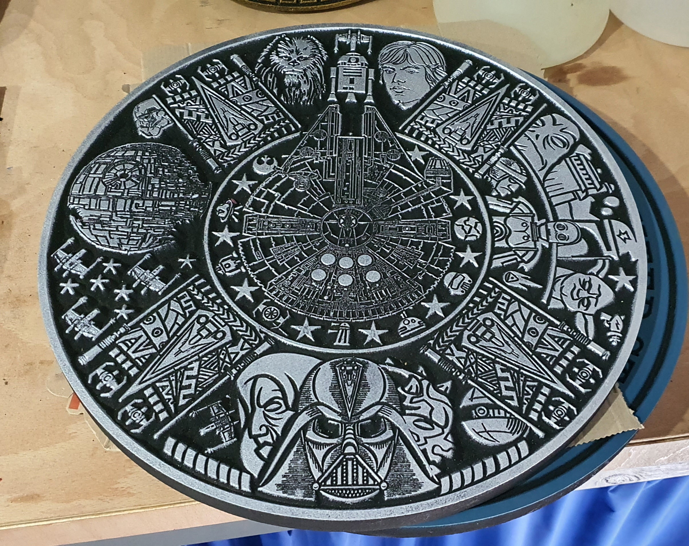

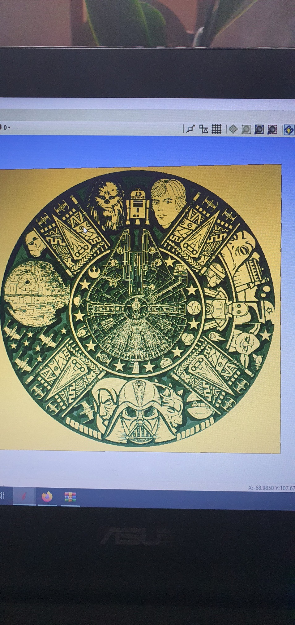

Iv started on the starwars version, what do you think?
Love it!
That is cool! The Falcon will take a while to carve.
Thanks Steve, I’ll find out today how long it takes and see how much detail I lose in the process
what bit you using? I have switched from the whiteside 60 to the Amana 45 for just about everything
I also used to use a 60 but now using a 45. I find it easier to use the same bit for everything, I’m lazy like that lol
I got it machined and didn’t turn out to bad, may change a few thing yet.

They both look amazing! Try setting a flat depth of 0.15" and using a better quality mdf. The stuff at Home Depot is brutal for carving. That should limit the breakage.
Thanks buddy, I upgraded the bit and it’s a far better cut than the ebay vbits. I should know better than to buy cheap bits lol
I have never thought of degrees of quality in MDF … most of which I buy at Menards. Any tips as to how to note better vs worse?

I changed a few things to make the falcon a little clearer
