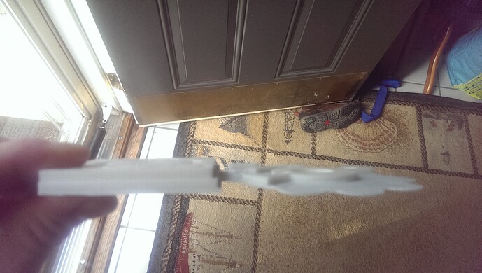

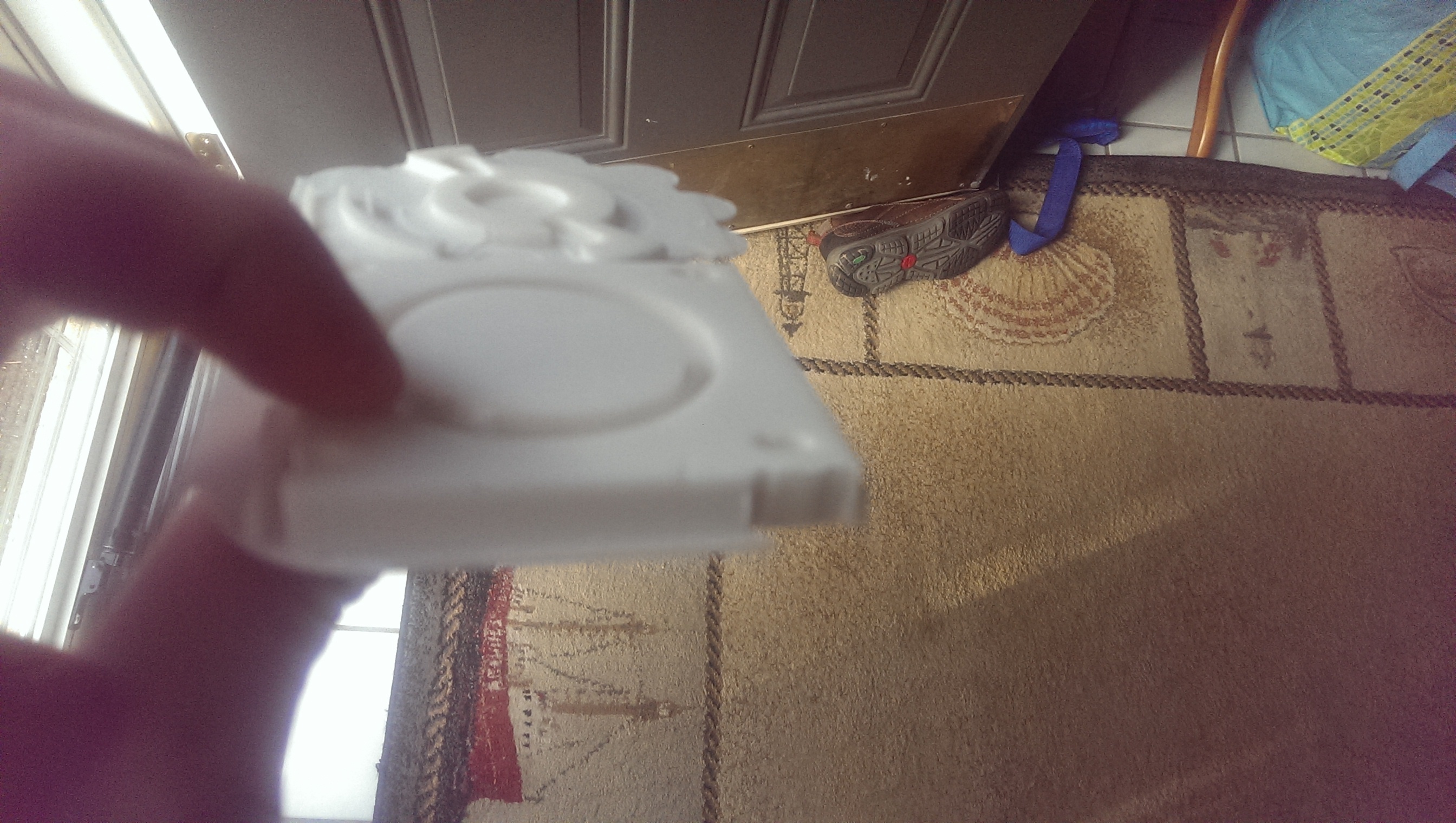

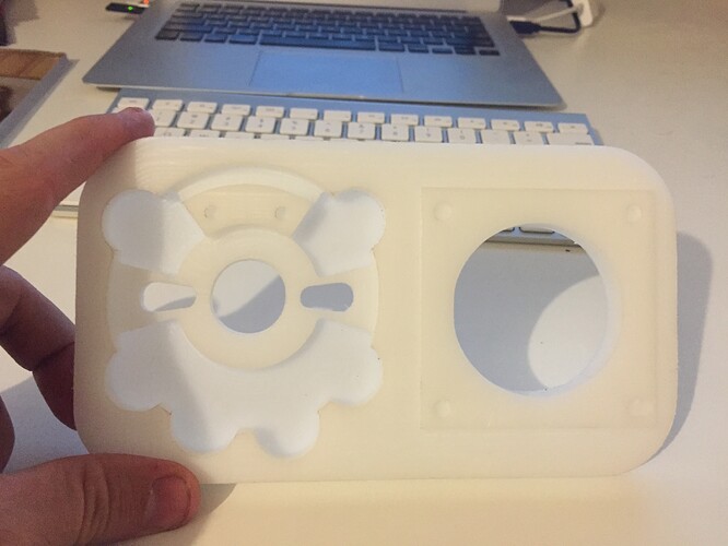

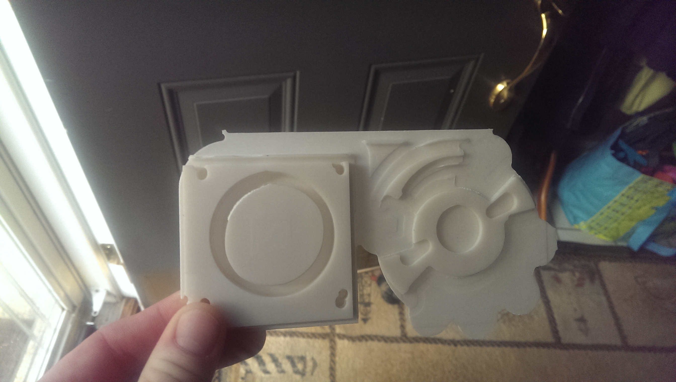

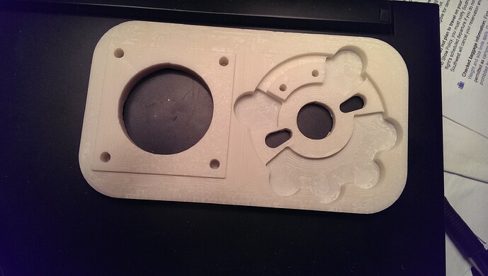

As someone else noted on the project page, I also ended up with an extremely thing piece of material left over and after going through the last tab the whole thing gave way and started to get caught up in the spindle. It seems as though there have been success stories here with the file so it has to be an issue on my end.
Did you cut everything on your file at once? I opened your file, set my zero on my machine, used a 1/8" bit and let it go. It dutifully ate away the 0.48" corian down to only sawdust and a thin wafer of nothingâŚany thoughts would be great. I am really getting tired of chasing my machine with a vacuum cleaner.
@JeremyHill I think you might have some issues with your machine, since I see that you have a few holes that donât match up and line up properly. It could be that your machine is getting stuck in an area and thinking it has moved when in fact it hasnât. I say this because Iâve run into an issue with holes and patterns not lining up on some of my projects.
I actually just cut out the TaylorLedak design earlier today, but I did make some adjustments to his file since my router is mounted in an opposite direction than most in this thread. I rotated the air diverter section 180*. I also changed the depth of the drill holes to only be 1/8" deep in their respective locations. I will drill and countersink on the underside by hand since I was also having an issue holding the vacuum line by hand a little too close to the machine (it ran into it a couple time causing it to skip).
I had to start and stop three times thanks to static electricityâŚAs I chased the machine with my vacuum, I would inadvertently touch the machine and get a shock. Once that happened, my machine went in a different direction. I would start over again using the same zero point and invariably something would be slightly off. The bigger problem was that it cleared all of the material away. So I will try again at some point in the near future. I am glad others are still having success with the file because that definitely narrows it down to me having an issue somewhere in my setup.
Youâre welcome @JeremyHill. It might be beneficial to work out your bugs on some test pieces of 1/2" MDF instead of wrecking a few more expensive plastic sheets.
success! I had to wipe the arduino as I was watching it twitch a bit too much in the rapid movements. I also did a tune up on all of the belts and v-wheels to ensure they were tight and/or loose as appropriate. So the part is cut now thankfully. I have the rest of the dust shoe coming in the mail soon. I look forward to having a relatively dust-less workspace with this set up.
