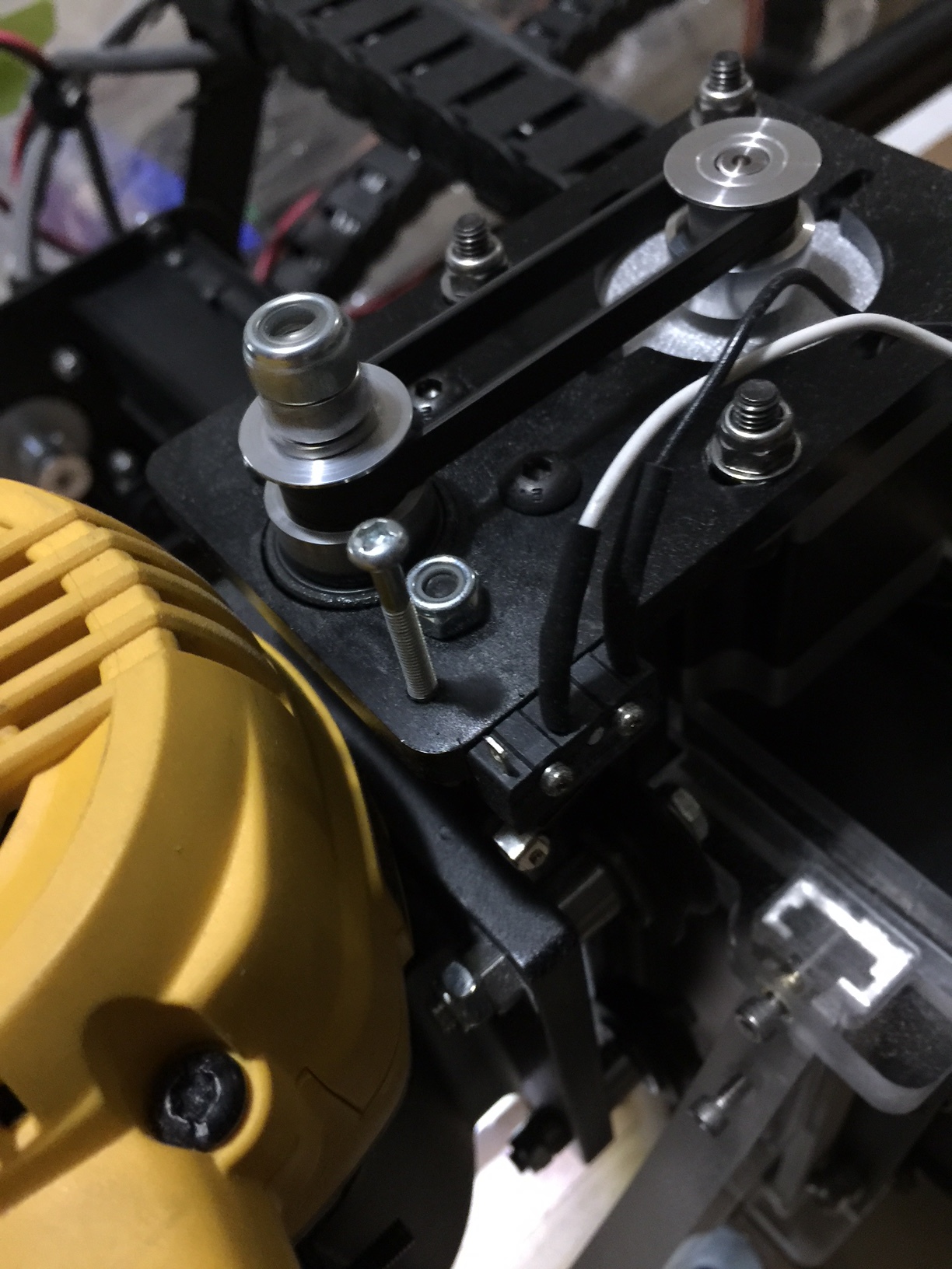

use the same method I did for the Z limit. Look below at the pic.
Notice the small but long silver screw? its the wrong type but I had it on hand. I used thread locker to keep it from vibrating out. It stops the Z from crushing the switch.

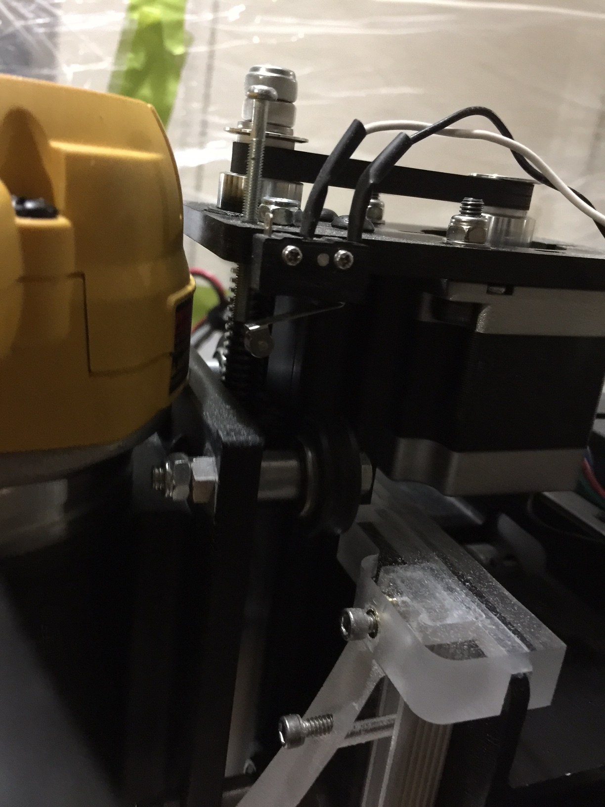

See 2nd image for a look under.
If you have homing working ($22=1) then I highly recommend that you turn on Soft Limits ($20=1). If you do this you will not have to worry about your switches or banging into the rails.
