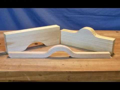

something with kerf bends:
or cnc’ing the molds for laminate accessories:

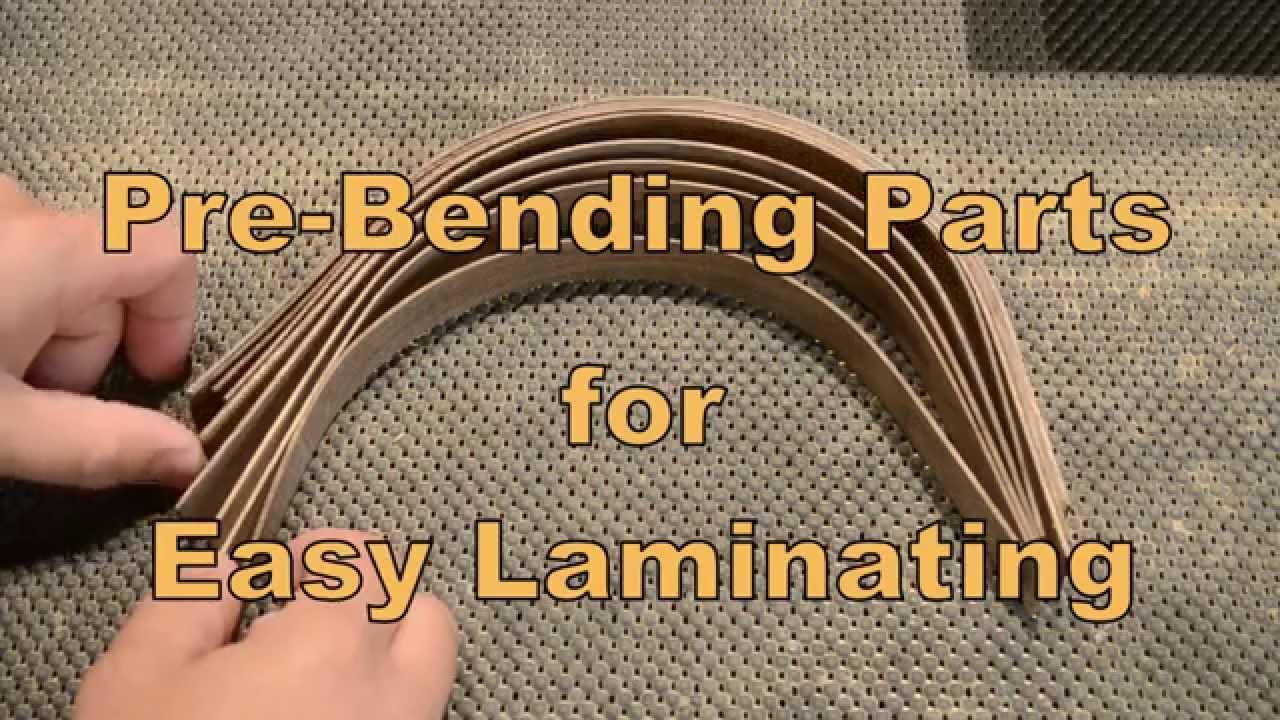

How do they do the bends that dramatically? Do they put it into a press?

yes they do but not as a whole obviously. They laminate thin veneers which can be bent in relatively small radii.
pre-bending helps too
You can easily use cheap woods for all layers except top and bottom one.

making the molds can be tedious with hand tools because most of the time you’ll need to cut it out multiple times out of sheet and glue it together to the desired thickness. So all pieces need to be exactly the same. A cnc obviously is perfect for this kind of work.
