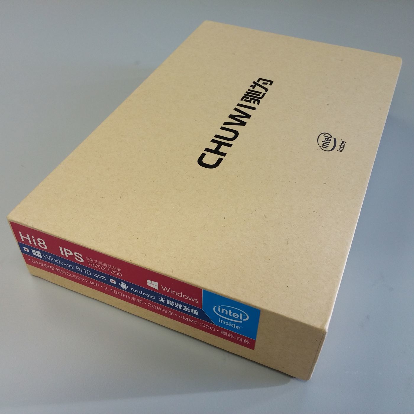

While searching for some deals on a bunch of parts for a Raspberry Pi based solution, I stumbled upon cheap Chinese tablets that dual boot Windows 10 and Android. This would be much easier to develop and package. I found a nice 8” (1920x1200) one that fit the top of the X-Controller perfectly for $83 (free delivery).
A key feature is USB “On The Go” mode. This allows it to be a master or a slave USB port. This would allow it to control a serial port.

The tablet has a dual boot for Windows 10 Home and Android 4.4. Android is an interesting idea, but a lot more work. I did try a simple terminal to Grbl using my Android phone and it worked fine.

I can’t guarantee I will ever release it, so don’t buy one unless you are ready to program it yourself. It is actually a pretty nice tablet though. It is very fast. The Android side has a few Chinese characters even with English selected. The case is a little plasticy, but it is very light.
