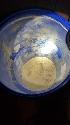

So i got a chance to dry run this program again and did not turn on spindle or vacuum and it seems to be doing fine. I’m not sure about the vacuum static. I do not have a ground in my cyclone dust collection system because i didn’t think it would matter but maybe you guys can tell from my pictures of the set up. I will try to ground it and see if that helps. Do you guys have ideas on how i can ground it best. My X-carve is in office and i have a porch on other side of wall so i decided to run hose underneath the table and through wall into porch and that is where i have my dust collection setup for less noise.
Some good info / how-to on how to ground vacuum hose found here:
http://www.cncsharktalk.com/viewtopic.php?f=2&t=2833
