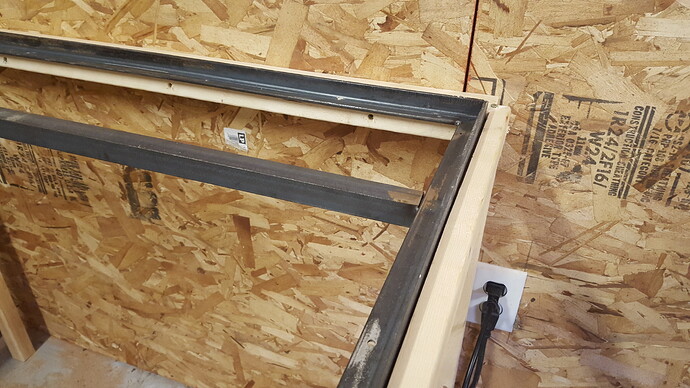

I’m preparing to buy and have a question I’m sure many of you have already dealt with.
My initial project is an art project and will involve cutting faces into beams and wood pieces of various sizes,
including pieces of cut / split firewood.
the question is how to mount a block of firewood onto the wasteboard while providing sufficient clearance for the milling head.
I understand some people may have created a ‘waste board with a hole in the middle’ type of setup, allowing for items > z-axis to be accommodated, and wondered if anyone had advice/pictures/schematics on how to set something like this up?

Here is what I did…
I went to a local fab shop and had a custom steel frame made for my X-Carve. It cost me less than $100.
I built a small, open wooden table to support the frame. PIcs are below. Hit me up if you have questions.
I had the fab shop cut 2 pieces of angle that match the width of the machine. I drilled holes so I could screw material to the angle and clamp it to the steel frame.
Here is a video of me flattening a log: https://youtu.be/iibeQiF_JAU
You basically have 2 options to do something like that:
You can modify the bottom frame to allow large items to be inserted, like @TysonSwan (awesome table!). You can include removable boards if you like, so you can mill small items and remove the board to mill something larger.
You can raise the X and Y axes by getting taller plates Y axis endplates. Inventables doesn’t sell them, so you’d either need to source them or make them yourself. If it helps, I made Y axis stabilizing braces out of 1/8" aluminum on my X-Carve (Y Axis Braces and Belt Dust Shield). If I was to make plates to raise the height though, I’d make them out of steel.
If you want to make your own plates, the drawings with dimensions are available on the Inventables site. All you’d have to do is modify them and then either make your own, or take them to a machine shop to get them made. If you use steel, be sure you paint or powder coat it so it doesn’t rust away.

did you need to do anything to chuck the table down so the motion of the milling head didn’t cause the table to move or vibrate?
It’s been a question I had how solid of a work surface I needed to mount the x-carve on…
Great question! I’m currently working on a mobile platform for my X-Carve. Once completed and tested, I will be sharing with the forum but I still have quite a bit of work to do with it.
It is very stable but I ran small bolts through the plates at the end of the Y rails into the angle frame. It is rock solid.
I have MDF pieces I can insert if I have flat pieces I want to carve.

The table is holding up very well, though I had to use a flattening bit when I put the MDF insert in place.

I wanted the ability to drop almost anything into that open space. I have mounted 60 lbs. stumps in there and carved. I’m not sure the existing frame would support that kind of weight and my opening is wider.
