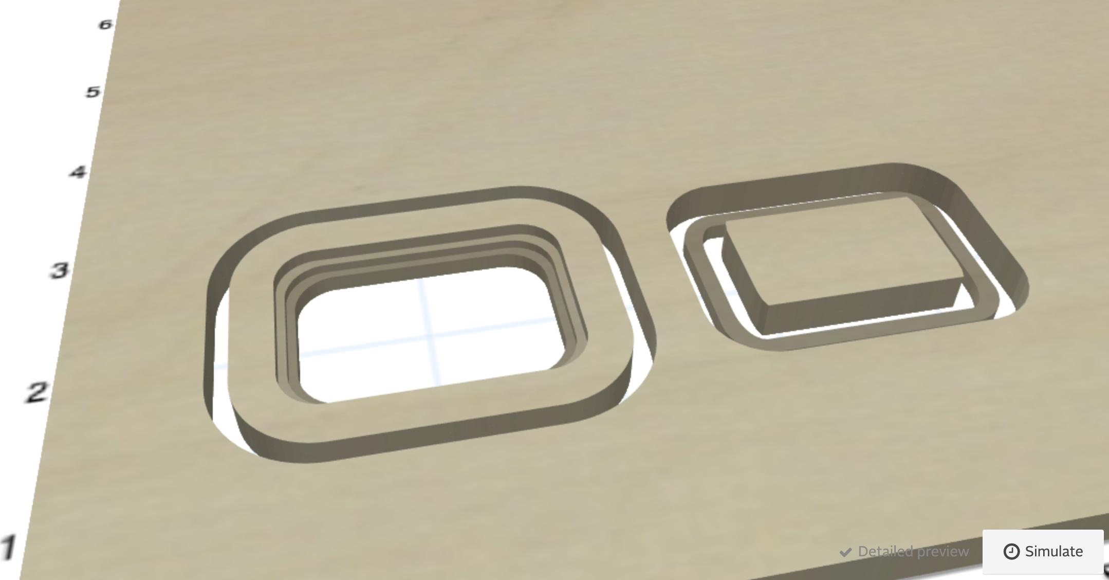

Hello everyone,
I just started using the Xcarve in a fablab, andd would like to know if it’s possible to make the CNC Xcarve do a groove on the side of a material and if so, which bit should I buy ? To be more accurate, I am cutting glasses shape with the CNC and need to make the groove inside which I will later insert the glass lenses. So the bit would need to cut in the profile of the material (see the pic attached
), leaving some matter above and under where the bit runs.
Thank you very much for your help, it’s precious
have a good day
Victoria

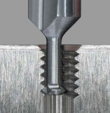

Here is an image showing a type of cutter that might work, thread milling bit:
thread-milling-cutter

Try Tormach’s threading bits. They are reasonably priced and solid carbide.
https://www.tormach.com/store/index.php?app=ecom&ns=catshow&ref=multicat_SF_THREADMILL&portrelay=1
One option to create the groove you are looking for, is to cut two separate pieces. Basically make a ring for the inside of the frame that can be glued into place to create the edge above the groove. This is a rough attempt to illustrate this idea.
