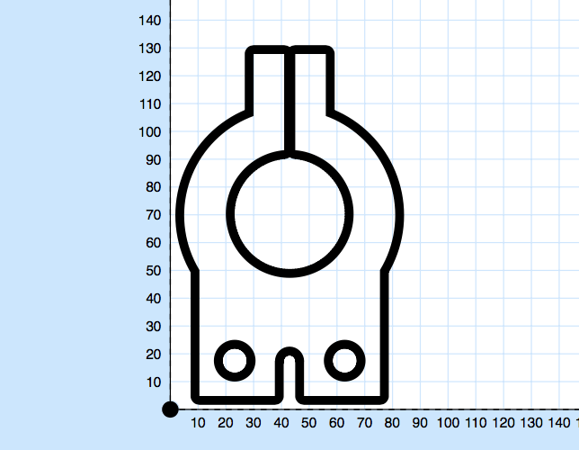

I purchased a 3018 Chinese cnc knock off, goes okay but the 3d spindle holder just discindergrated (SP).
I found one online that is cut with the cnc but in ply or alloy but It’s in a Step file.
Ihave installed Fusion 360 (well over this old mans head) can open the file in 360 but thats about as far as I can go.

I don’t use fusion 360, but I create gcode from 3d with meshcam. It has a 30 day free trial. It is pretty user friendly, as it has about a 8 step linear process from start to finish. It may be worth the effort to try it since you have the drawing already.
Easel only, adjust material thickness to your liking and cut multiple ones to give you the overall thickness desired. Internal cutout is set to 46mm to give the design some fudge factor :
