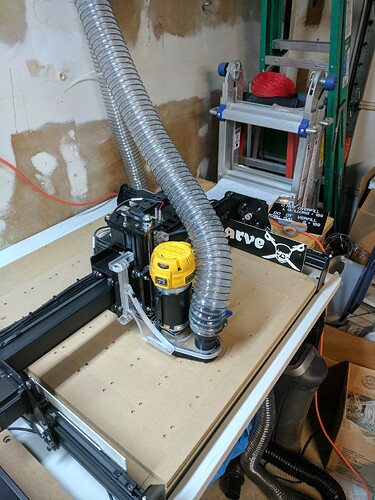

Great design that requires no permanent attachment. The whole thing can be removed with 4 screws. It captures 99% of the dust from the finest MDF to acrylic shavings so far, and has proven to be quite impressive.
I use the G30 “tool change/parking spot” after setting HOME, but before the carve to slide the shoe into the bracket. With $40 in extras from Amazon, plumbed the boot into the Dust Deputy, into the ShopVac.

I got the MZD with hose adapter. If you’re using a DeWalt 611 you’ll want the MZD version for sure. It has a recess for the z axis to have another 1/2" or so.
I experimented with a couple different designs, and from what I can tell the reason why the Suckit is so effective is that it is so low to the surface. It really transfers the vacuum power efficiently where as if it was further away from the surface it would lose power.
For me it was actually too close to the surface.
The 1" brush that it comes with, caused the frame to run into my clamp screws.
Jenn was gracious enough to help me out with where I could get a longer brush.
I now have an 1 1/4" brush and all works perfectly.

I hooked mine up with dryer hose and the dust collector is trying to collapse the dryer vent hose.
I have a video and will try to post.[quote=“DavidRechenberg, post:22, topic:32816, full:true”]
