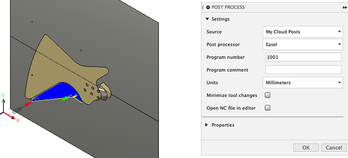

I’ve been playing with complex 3D curves in Fusion 360, and importing the GCode into an Easel session in its own workpiece. So I do all of my 2.5D carving as normal with Easel, then go to the new workpiece in Easel to incorporate curves.
My issue is when the GCode generated by Fusion 360 has finished carving successfully, and the cutter is at its lowest depth in the Z axis, the machine returns home without retracting, eating everything in its path.
Does anyone know what GCode I would need to append to the end of my existing GCode to force a full retract before returning home?

My Z zero was set with the probe, from the top of the stock. The carve completed, and I was watching it and feeling very happy, then BRRRRRRRRR!!! right through the workpiece on its jolly way home.

Not sure what my post processor in Fusion for exporting GCode is right now, that computer is updating its OS.
I use a PP from Strooom which let you define where you want the machine to retract to after a carve, its downloadable from here - A better Fusion360 - GRBL PostProcessor

i had the same issue awhile back with running my fusion models in easel if my Z was not pointing up in my setup and from the looks of your setup that is not the case. you change the orientation in your setup by clicking on the arrows to reorient the z to point up. after i reset that i never had that issue again. also set your stock point to be in the front top left corner of the stock, this too gave me issues when my fusion models had that set to the bottom of the stock
