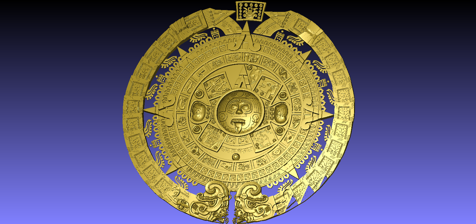

Finally picked up a bit that should be able to do some justice to the Aztec Sunstone stl file. I’ll try to make time to cut it this weekend.
Tapered ballnose with a 0.25mm radius.

Here is my latest cut from today. Cut in 3/4" Pine with 3 bits:
1/4" endmill at 80 IPM, roughing pass 1 hour 58 minutes
2mm radius tapered ballnose 85 IPM with 20% stepover: 56 minutes
0.5mm radius tapered ballnose with 85 IPM 20% stepover: 2 hours 57 minutes
Need to do a little sanding and fuzz removal, the piece is about 12 x 6 inches and will be inset in a door for a small cabinet. The other door will have a similar carving.
What software did you design this in?
I bought the model as an STL file.
Into Easel or Vcarve
The toolpaths were generated in Aspire, but V-Carve will also work. I am pretty sure there are some free programs that will import an STL file as well.
