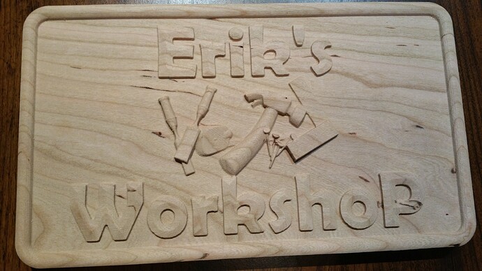

Quick sign for my workshop. It is 3/4" x 7" x 12" in Cherry.
1/4" Endmill for roughing pass at 65 IPM - 45 minutes
0.5 mm Radius Tapered Ballnose for finishing pass at 75 IPM - 15% stepover - 1 hour 25 minutes
1/8" Endmill for cutout

Erik - would you mind outlining the process you used to create this? I’ve got several sign \ plaque designs in my head, but I’m wondering the best way to approach it… VCarve design followed by GCode export, into Easel or UGS, or VCarve design followed by export of SVG or something similar into Easel? I am assuming the ballnose means 3D, so does that mean VCarve, or FEngrave, or something else completely different?
Thanks in advance!
I used aspire for the signs above, but both signs could be done in V-Carve minus the border (which was modelled in Aspire - it is a 2 rail sweep)
The coffee cup model was an STL file I simply brought into the program and the text was V-Carved.
The workshop sign was a little different, same two-rail sweep for the border and an STL file for the model of the tools, but this time I created raised text (Also possible with V-Carve just google this video - VCarve Pro - Machining Raised Bevel Letters)
I generate a roughing toolpath and a finishing toolpath, save the g-code and use a nightly build (version 2) of Universal G-Code Sender to send the code to the machine.

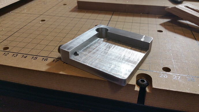

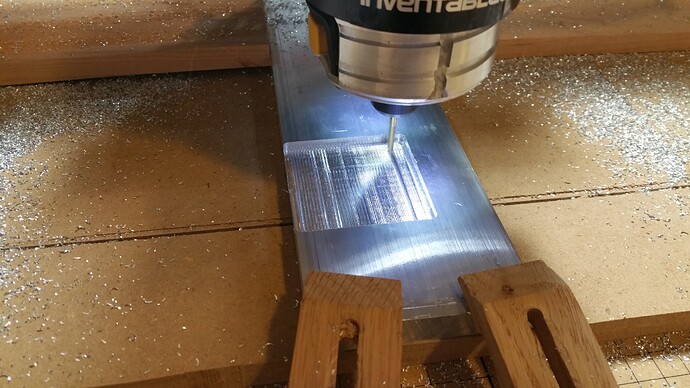

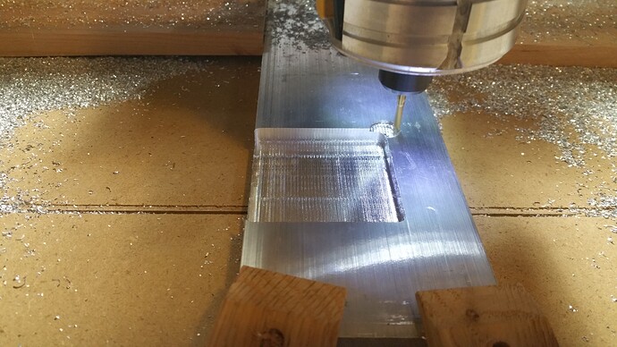

I decided to give aluminum cutting a try and make the 3-Axis zero plate.
I used a 1/8" endmill with a titanium nitride coating. for the entire piece.
I cut at 45 IPM with a 0.02" depth of cut and a 20% stepover for the pockets. I had the Dewalt set on speed 2.
I was incredibly pleased with the accuracy of the X-Carve, the aluminum measured 0.506" thick and I cut 0.25" for the large pocket it measures 0.256" now. About as accurate as I can measure.
After cutting it out, I used 400 grit sandpaper and even though you can see the toolpaths, I can’t feel them.
I drilled and tapped a 5mm 0.8 pitch hole to attach the wire. The wire will be connected with a spade connector.
All wired up and tested, works beautifully.
