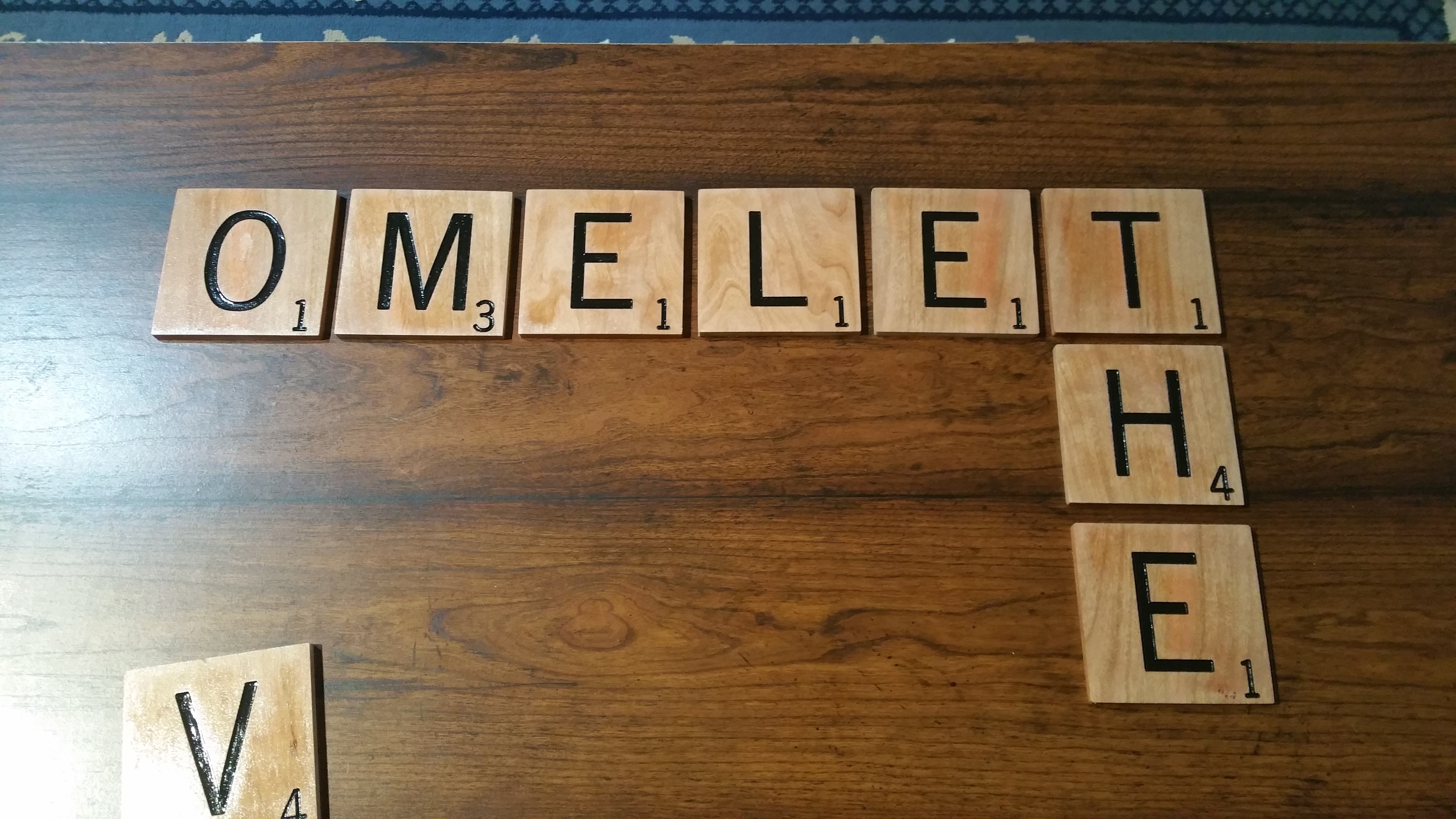

Bad picture, but here is a small shallow carving…each one is 4 inches across this is straight off of the machine. Carved from 1/4" cherry. I’ll try to get a better picture later…I was melting out in the shop all day today…too hot :slight_smile:

Scrabble anyone? :slight_smile:
I only needed 7, but since the wood was there, I went ahead and made 2 extras…an E and a T…coasters, one for me and one for my wife :slight_smile:
Now…sand, seal, paint, sand, seal and hang :slight_smile:

I have to assume its going to be :
H
LOVE
M
E
Or something similar?
Love to see the finished product…
Yep…home/love. I’ll post a picture when it is finished.

I sealed the wood with polyurethane, used a brush for the black and then sanded the excess.
Here they are before I sanded the excess black off.
Ha, that’s funny. When I first saw your post, I was trying to figure out what you were spelling and all I could see was omelet.
